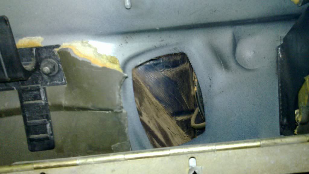

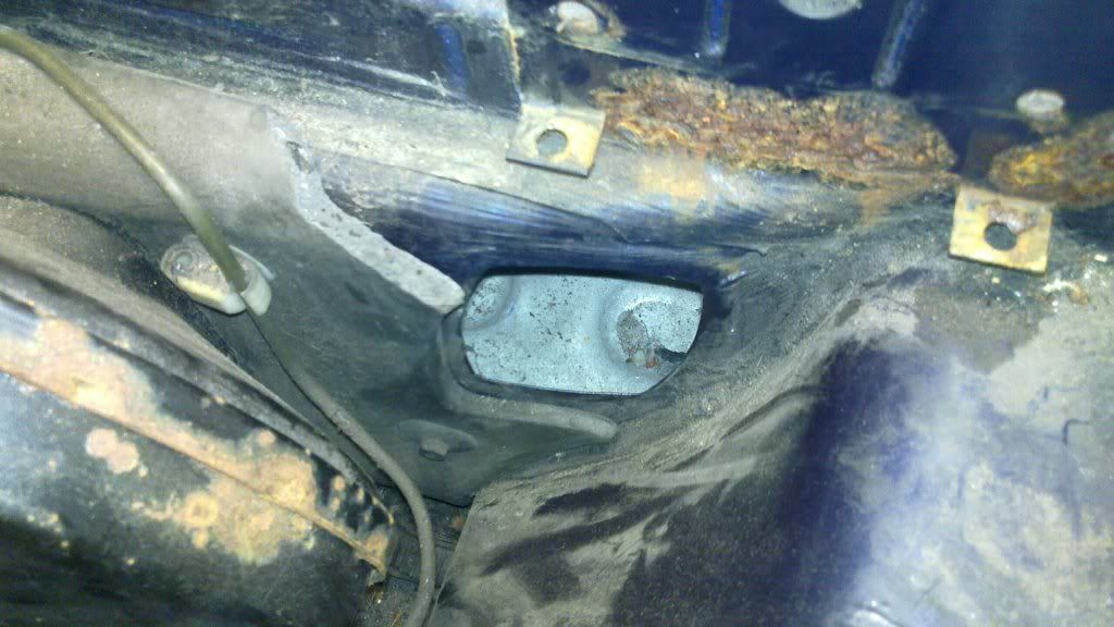

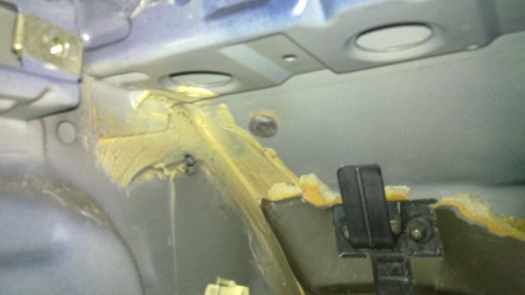

just got some shots of one I'm fragging.
note the hole where the bonnet release cable comes through up and right from the rusty stud. That should have a long rubber grommet sealing it.
The big square hole with rounded corners is below the fuse box and has a ton of cable coming through also should have a bung/grommet sealing it.
Thats a dumb close up of the cable release entry :roll:
Inside view of cable release entry
cables entry hole
I would say its either entering via the front screen seal, is this OK and all metal strips joins are tight? All the way round the screen.
is the sunroof sealed well are the drain hoses all ok?
Is the rubber seal correctly seated along the top rear of the engine bay?

The section of bulkhead where the glove box bolts in place is double skinned. The skins go upwards, where they split forwards and backwards to form the bottom of the area under the scuttle panel. If (when) the sealant along the place where they split fails, then water that gets in through the scuttle vents goes down between the two skins, and typically rots through the rear one by the fixing studs for the glovebox.
