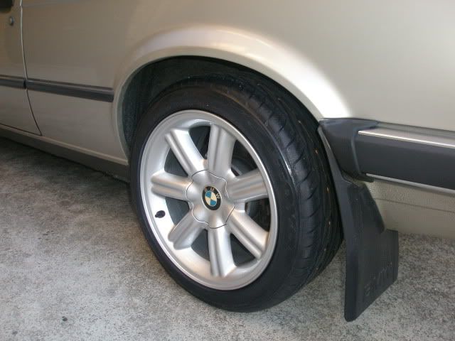

205x45x16 on mine with Eibach Pro kit - gives about 1.5% speedo error
