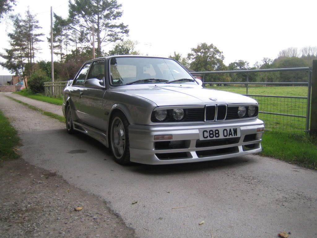

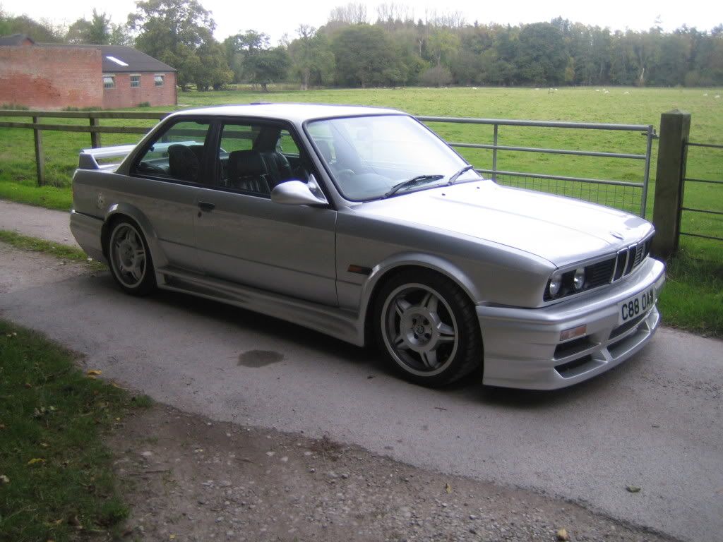

i take it the car in question is the one in your aviator pic?
sure i saw it on ebay about 6 months ago,
does it have custom interior?
it went for about£1400 (i was tempted myself)

Well spotted! It is the one from ebay a few months ago. I bought it and then had the 600 mile round trip to bring it home on a car trailer. As far as servicing goes, I havent done anything yet. The previous owner bought it as a non runner. He changed oil and plugs, put in fresh petrol and replaced the seized injectors with second hand ones from a breakers, new rotor arm, got it running, MOT'd it and that was it. It still hadn't been driven very much.
