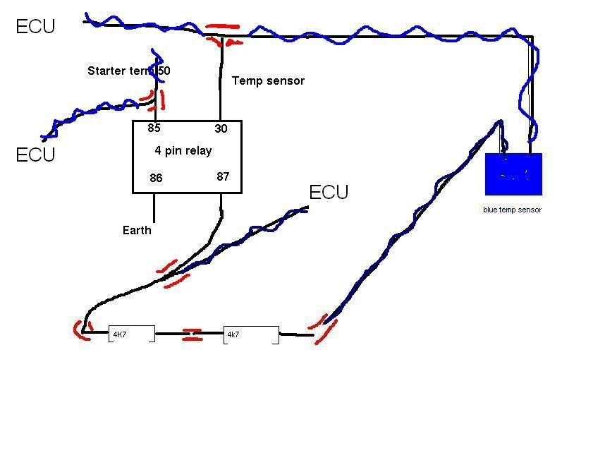

here's my circuit then as it will actually look (I've chucked in 2 x 4k7 in series, same diff). The red bits are 'joins', and you can see where I've chopped into the wires leading to the ECU.
Look right?

I think that's right!
I'm not too sure about the starter (term 50) connection - is that going back to the ECU? I'm a little rusty on the older stuff, but I do recall that the cranking signal does go back to the ECU - in which case it should be ok.
I would connect the earth and the cranking signal first, and make sure that the relay is energizing, and also check with your multimeter that you are getting the desired resistance across the other two wires(when cranking). Once you're happy that everything is ok, you can go ahead and connect across the temp sensor.

according to Haynes...
the starter 50 goes to ECU #8 and #4
the bluetemp BR goes to: ECU #5, and to 'throttle switch'
the blutemp BR/R goes to ECU #13
so I was just going to cut one of those ECU wires for the starter, and two for the bluetemp and connect in at the split as in the diagram, binding the three ends of wire together at each join.
