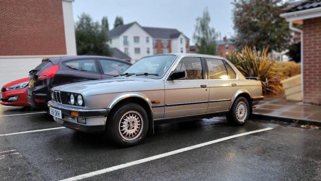

Hi. Here's the car. I did look at that article and it said i should i have a set of rear trailing arms with all those parts attached to it but i don't have those parts or know what part numbers they are. I've got a set of discs and pads, and i think i know which caliper. I'm struggling with knowing which are the other parts as I'm not familiar with them.
I can put them together on a bench and then install them on the car.
