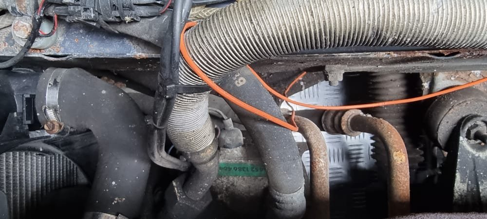

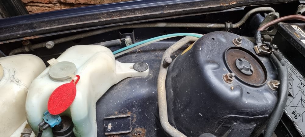

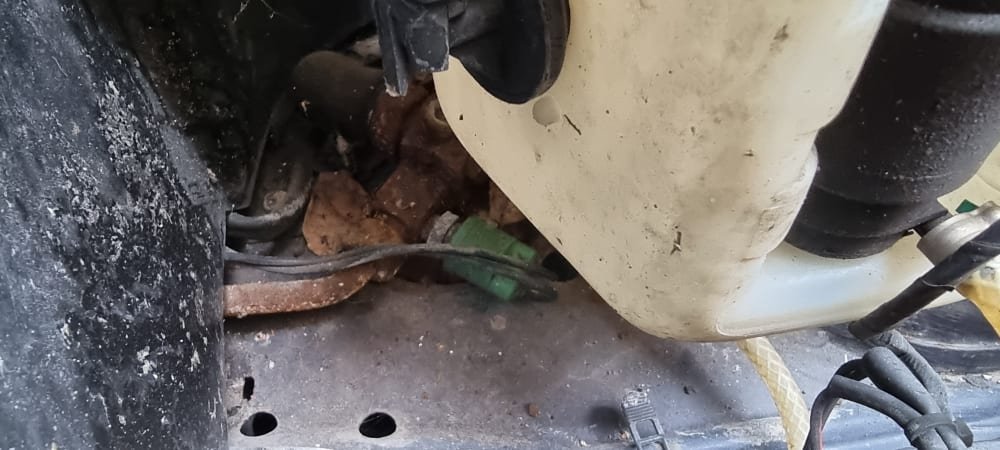

I'm hoping the pipes are all OK as they look pretty rusty externally. Donor car has been dry stored for 12 years. Hopefully they are okay internally and I can clean them up.
