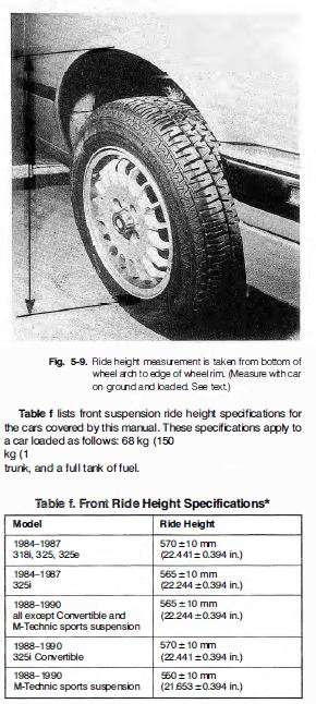

If you look in Bentley it gives models. springs as well as spring pads and ride
heights for all models, also where to measure. It is of course American but I
think there's no difference in these settings between Europe and US
Paul :-)

i checked the bentley.
but it only has the front ride height somehow...
I'm sure i didn't miss anything
so has anyone got the rear ride height?
