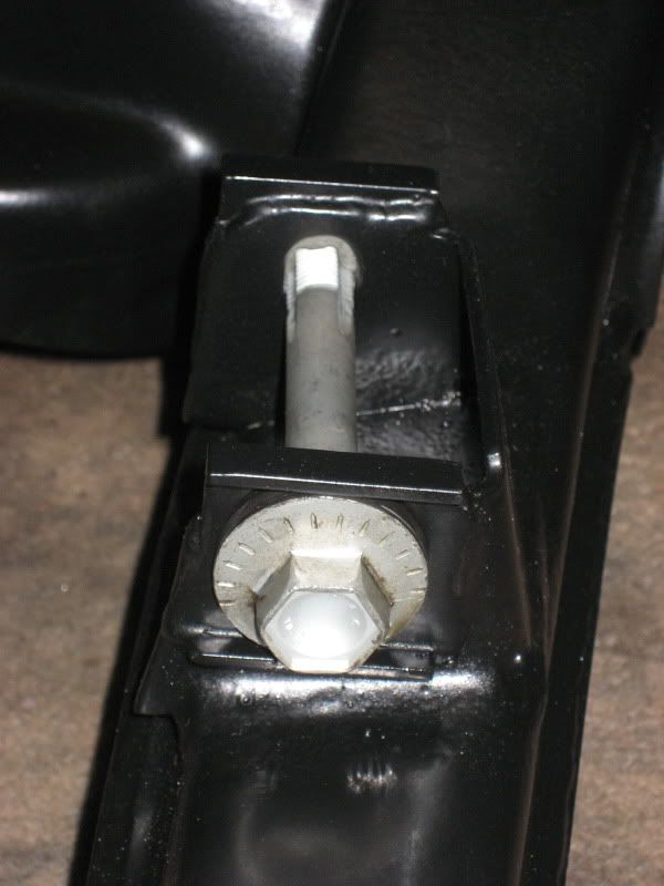

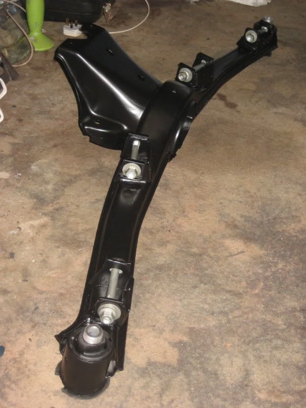

you need to get adjustment tabs welded to the rear beam, then you can use eccentric bolts (from an e39 iirc) to adjust the toe and camber.
