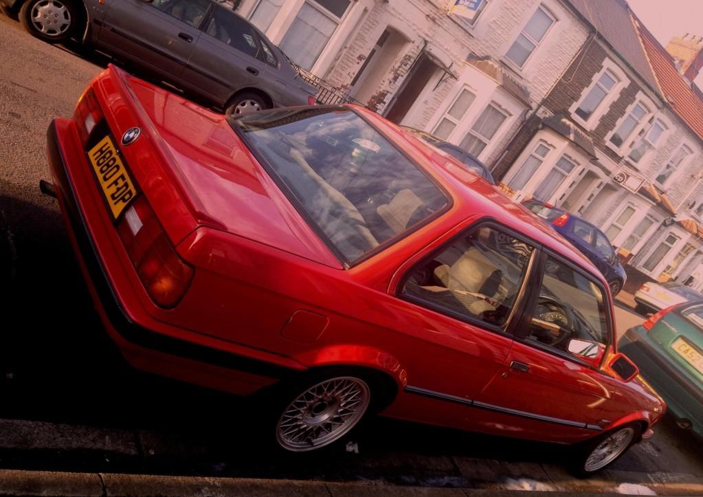

My car on a 60/40 Drop:
With Original 15" BBS's, Fronts are 205/50/15.....Rear 205/55/15 Nexens all round.
Aiming for 16's this year with lower profile so should sit better.
This is after settling in obv and polybushed throughout very firm and comfy ride.
