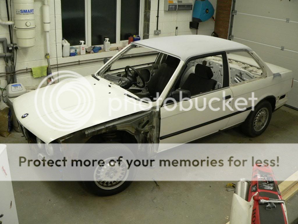

I also have put some pics on.

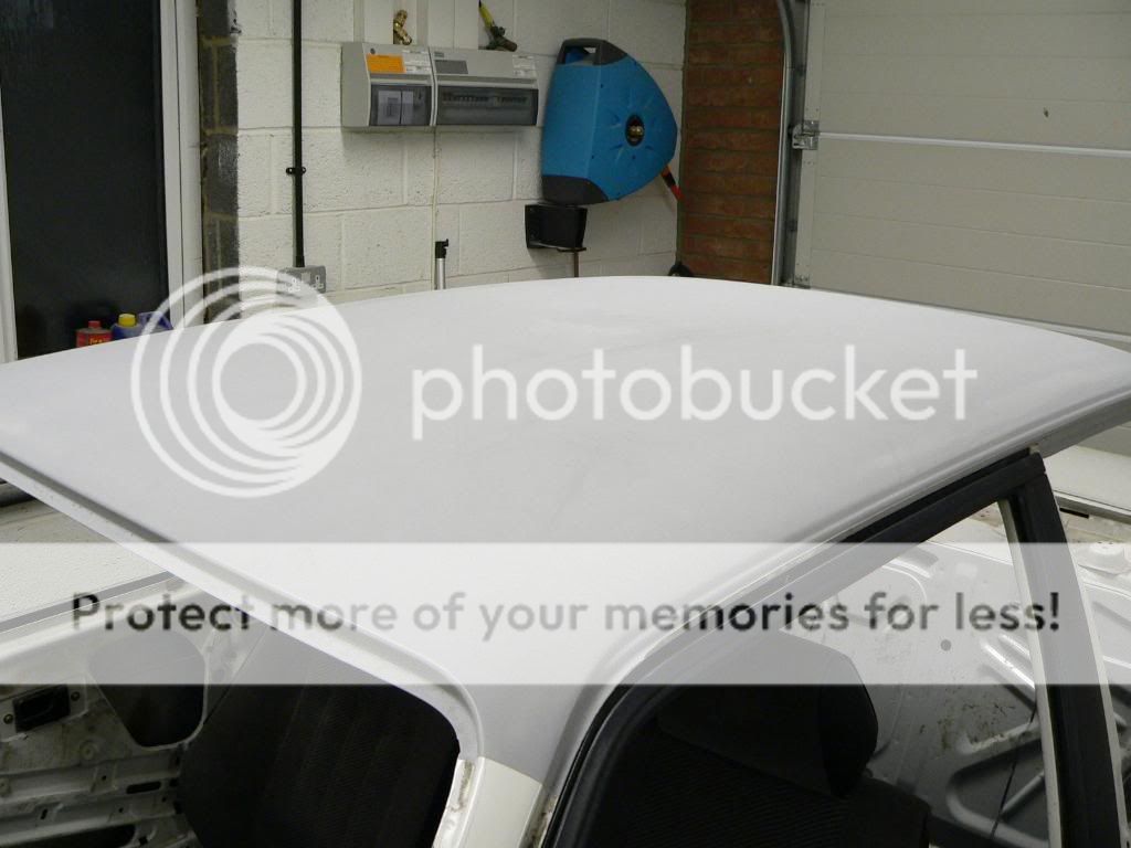

One is of a sunroof patch that we joddled and tig'd in which works quite well if you have the patience of a saint.

That first picture is great, I love when they look special and shite at the same time.

Definately more of the shite than special unfortunately.

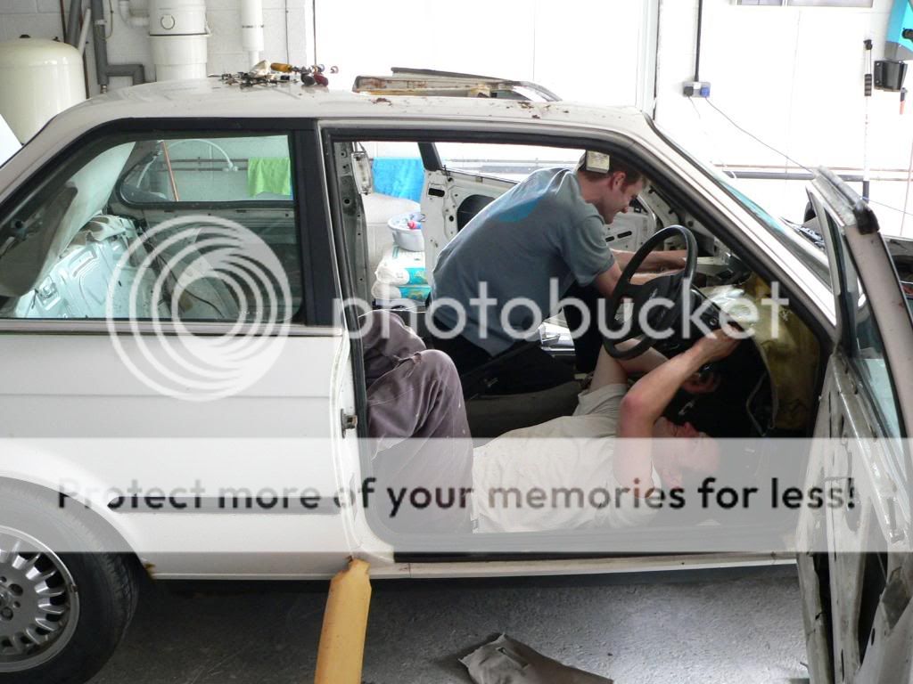

Them two 'mates' in the other picture really loved spending one day ripping it to bits.
