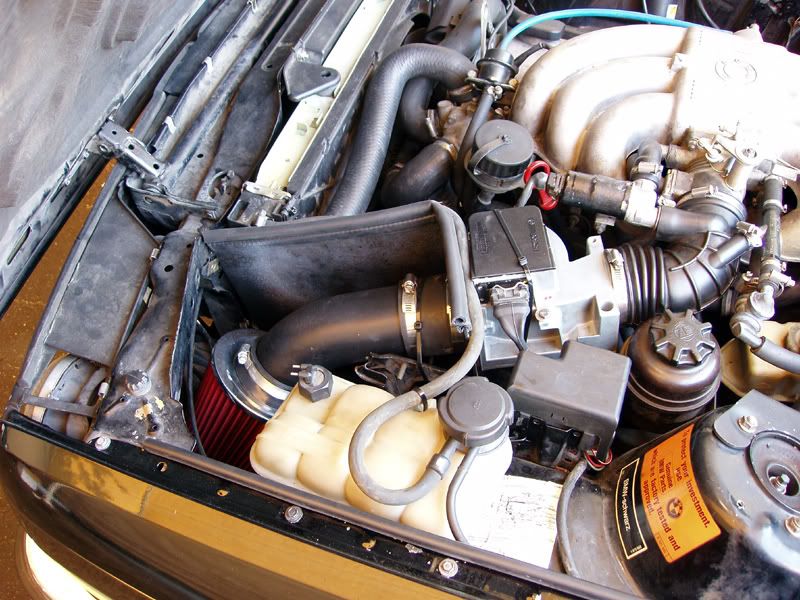

If its for a cone filter something like this.

The original BMW airbox is pretty good at feeding cold air anyway, seeing as it's situated just behind the light, and if you have all the correct plates and tubes etc. there aren't really many ways that hot air can get into the airbox.

i have a cone on str8 of the afm with no heat sheild was like this when i got car! is sucking all that hot air in damaging my car im sure its down on power?
GrindCulture
Posts: 2955
Location: Exeter
Wed Apr 16, 2008 7:31 pm
If it's a branded filter like K&N you could probably sell it, go to a scrappy or scout ebay for a proper airbox and do it that way. Unless you like the noise/appearance of the cone filter, then build a proper heatshield like ed demonstrated and see if that makes any difference.

oK IVE JUST REALISED SOMETHIGN LOOKING AT THE AIR FILTER SHIELD PIC, I DONT HAVE THE cONE AT THE START OF THE INTAKE PIPE, I JUS HAVE A PIPE WICH OPENS WIDE LIKE A TRUMPET INSTRUMENT AND THATS IT BUT NO cone SHAPE FILTER:s...IM CONFUSED NOW...LOL
