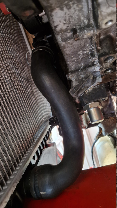

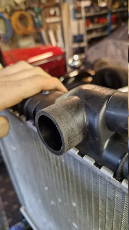

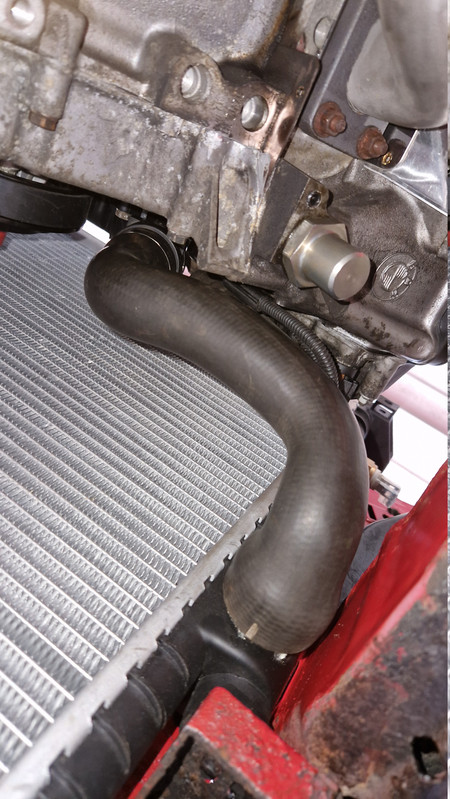

For the bottom radiator hose, I used one from a Z3 (11531716642) It has the quick connect fitting at the top to mount directly to the thermostat wirthout modification, the lower half of the hose can also be fitted up without modification but I found that it caused the hose to stick out too much and slightly rub against the timing cover which over time may cause it to wear through! I chopped around 10-15mm off the end of the bottom half of the hose and did the same with the outlet of the radiator, I lightly scuffed up the outlet with some emery paper to allow the hose to grip it better. Fits really nicely now.
Without modification:
With modification:
Radiator outlet:
