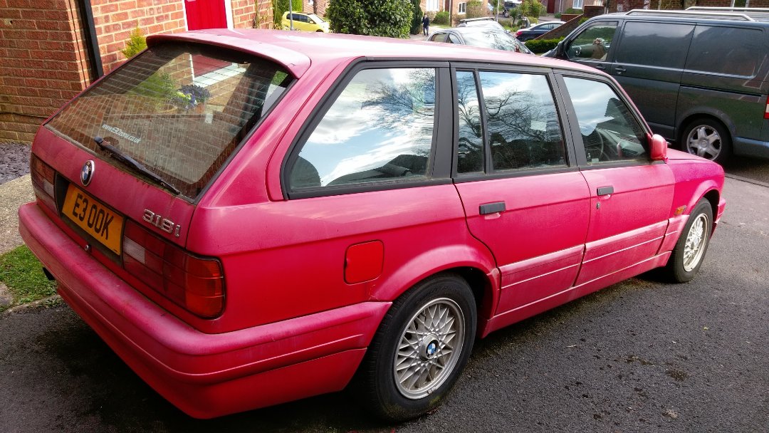

Bought 01/02/2007 with a dodgy MOT, interesting drive back from Norfolk to Dorset, I left a trail of petrol all the way back.
I drove it for a couple of years, then parked it up when the MOT ran out, kept meaning to do a few things for the MOT. Suddenly 10 years have passed, left outside on the drive. The neighbours loved me 8)
Every once in a while i polished it to appease my long suffering partner, and keep the neighbours happier.

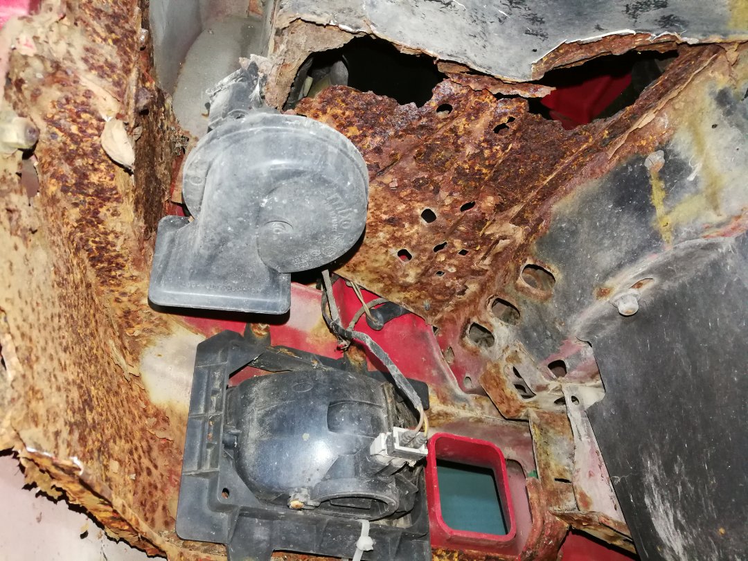

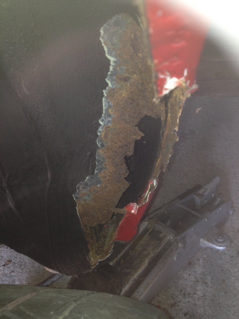

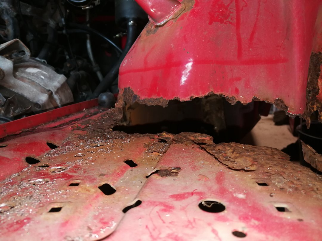

Now, what could be lurking behind the bodykit :?:

Thin air….

Even without a kit. Be brutal

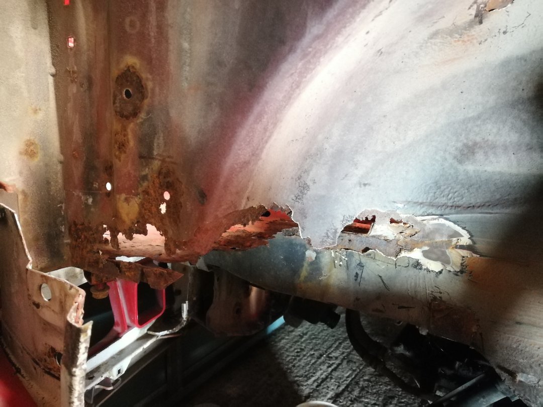

Not just thin air, a good sprinkling of rusty bits pretending to be metal.
I should have just weighed it in, but I owe the car one last chance of survival
Sat Feb 26, 2022 3:44 pm
Looks like its a had plenty of sea air!

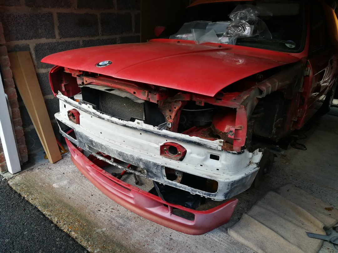

Yummy, have de ja vu vision of mine. For the valance, hillbilly way could be to chop the rust out and the Mtec bumper remains.
The upper bit panels could be got or made.
Can we have a photo after hammertime, here’s my inner wheel arch, I was a bit keen to find solid metal….

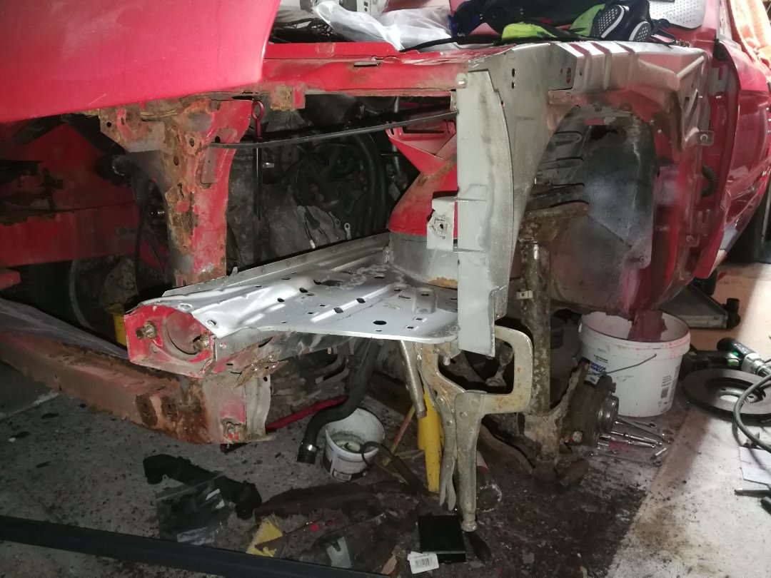

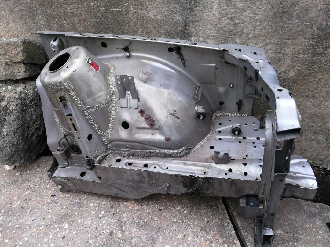

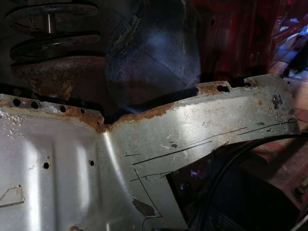

I've got a new(er) front valence,
Time to get the grinder out
Mark999
Posts: 18
Joined: Sun Dec 13, 2020 11:25 am
Sun Feb 27, 2022 5:50 pm

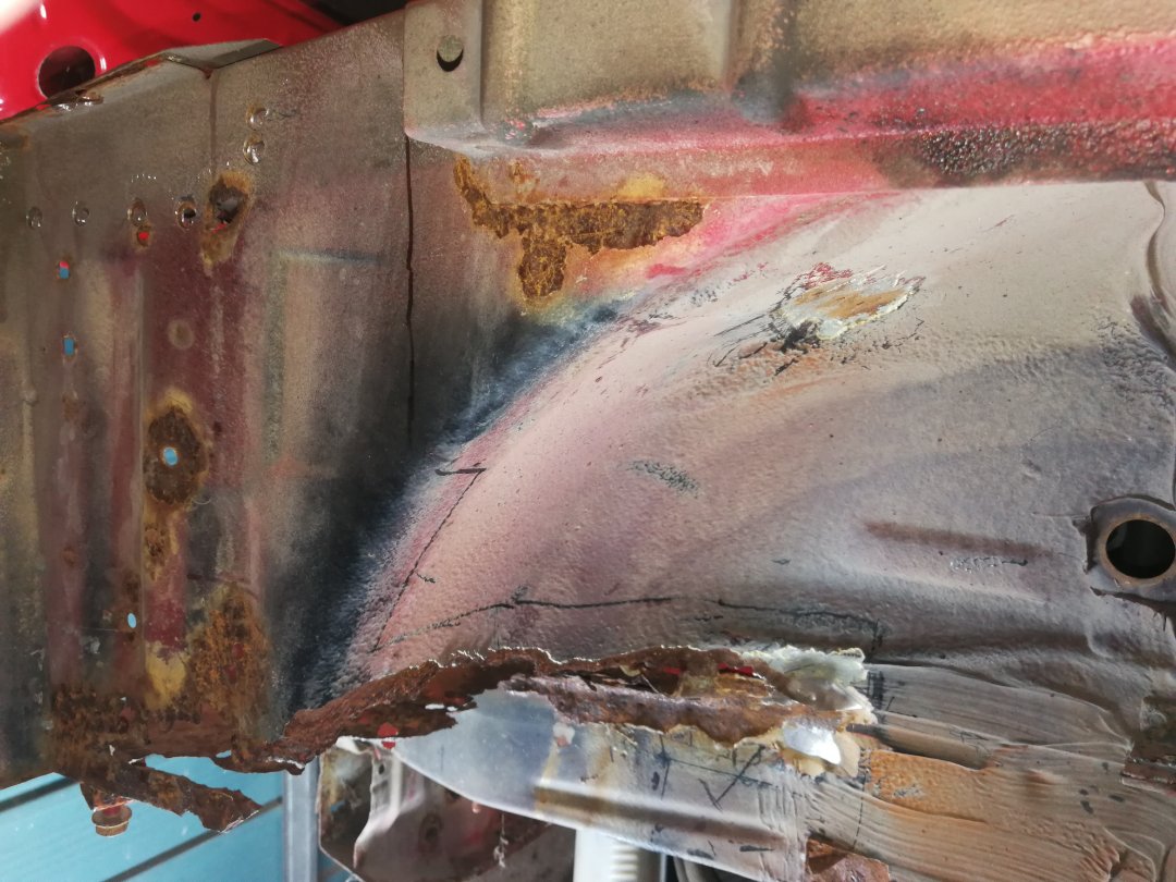

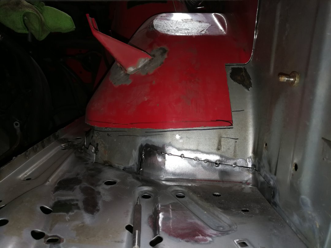

Donor panel...

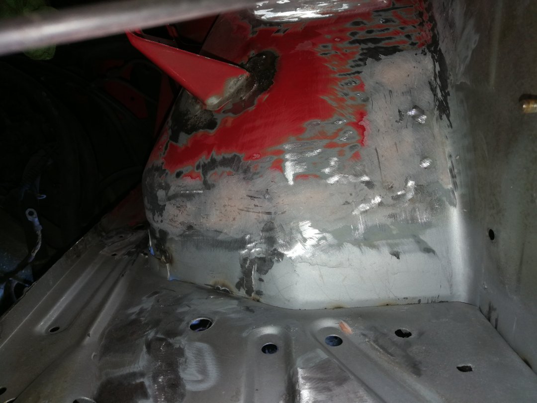

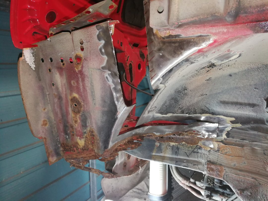

Out with the old
Repairing the repair panel
Small amount of rust in the corner
Mark999
Posts: 18
Sun Feb 27, 2022 5:58 pm

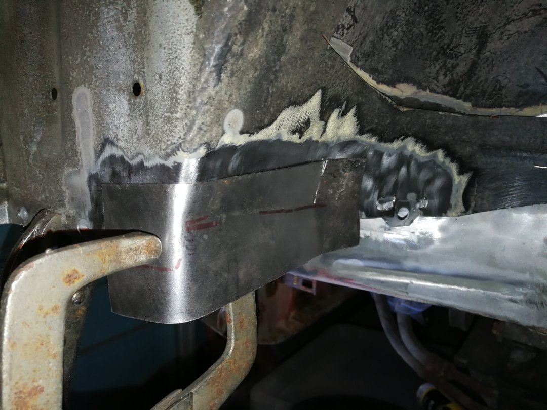

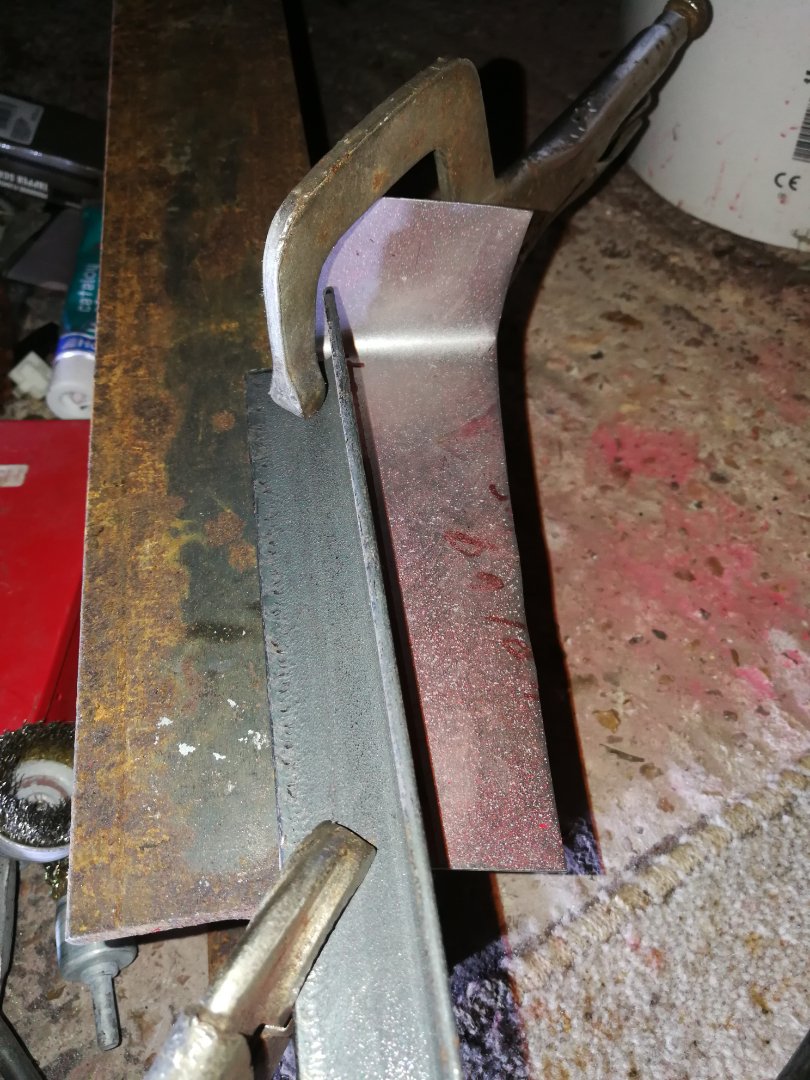

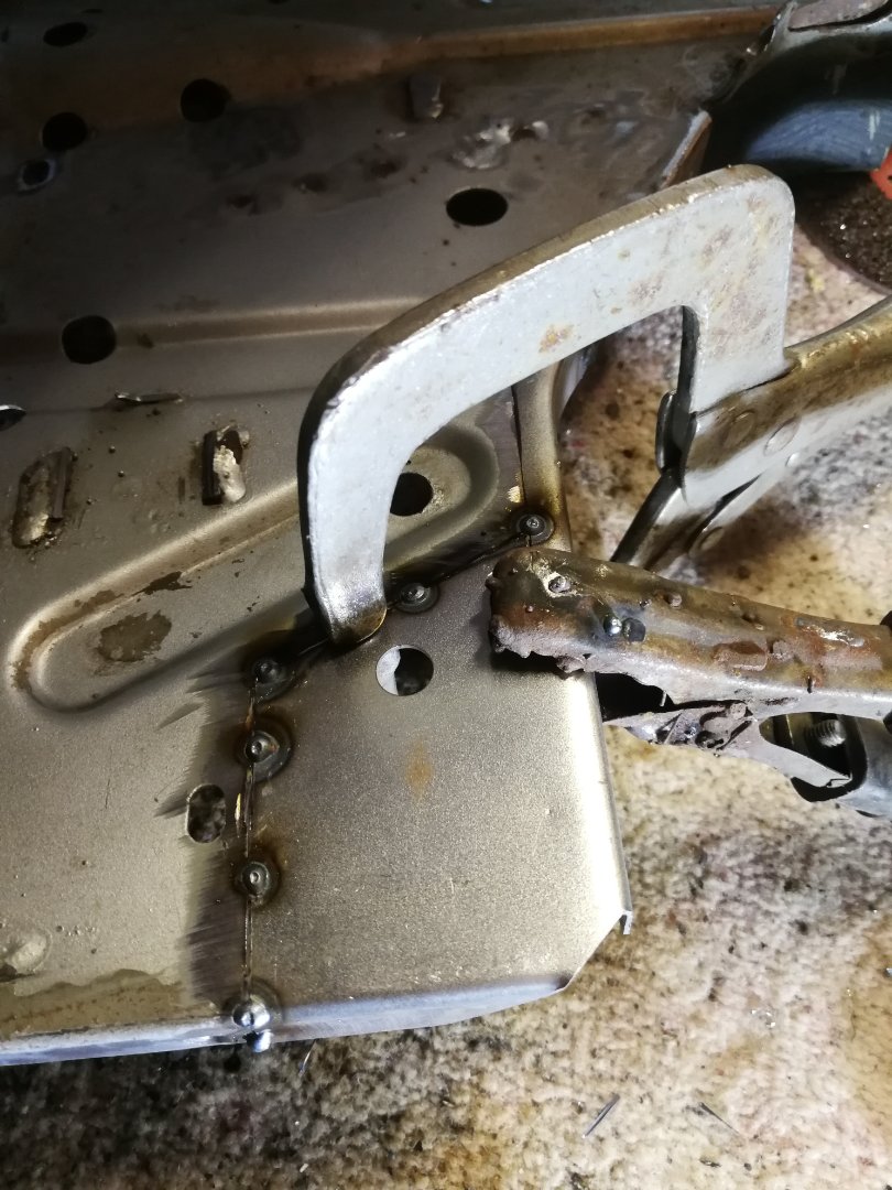

The latest High Tech tooling
Bend panel around a 17mm socket to get the OEM fit

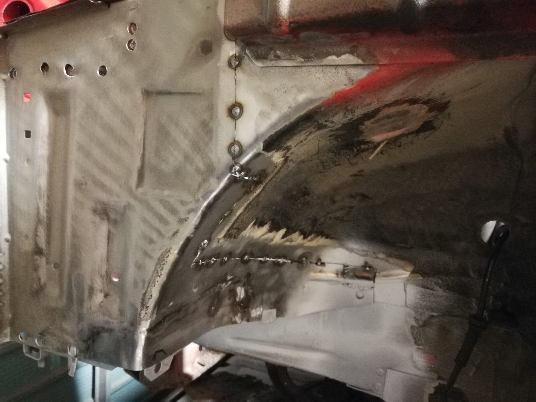

Trial fit... Repairs to the repair panels. Start of a very big jigsaw.
Satisfying to weld bits back in rather than just cutting rot out

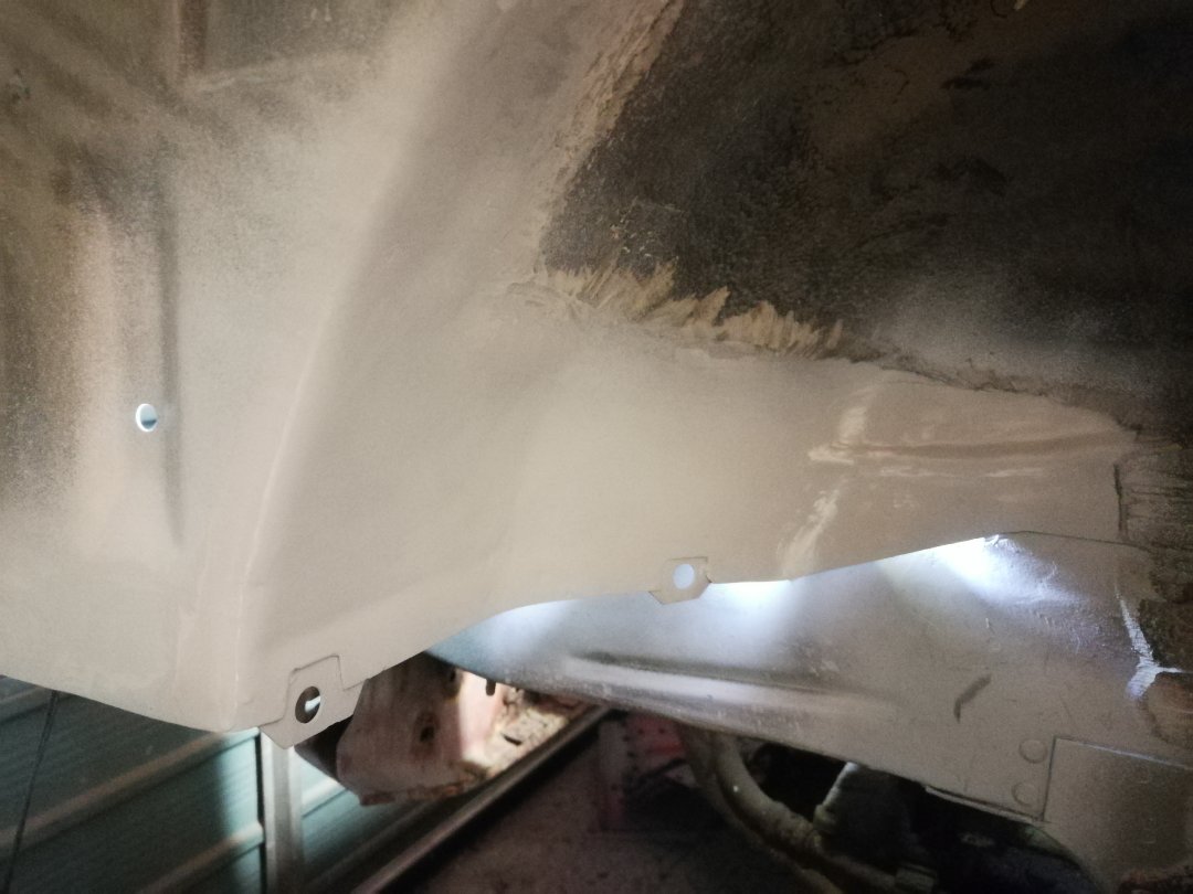

Bit of fiberglass over the ground down welds, just incase of any pinholes in the weld.

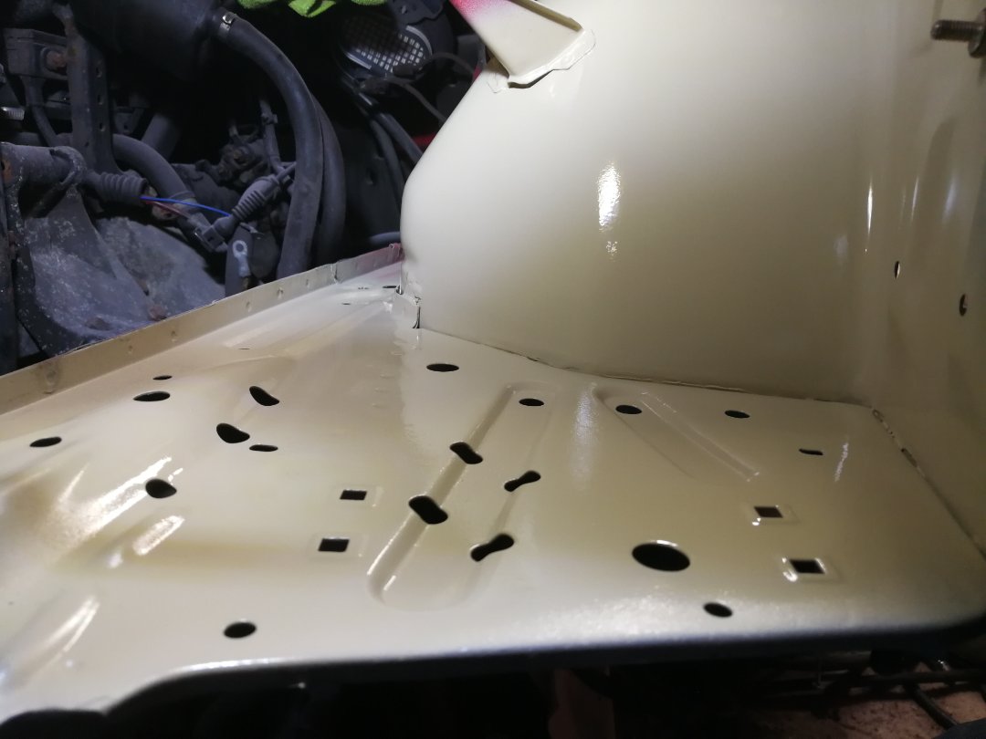

Epoxy primer
Epoxy primer, should keep the rust out for the next couple of years whilst I get around to doing the rest of the car!

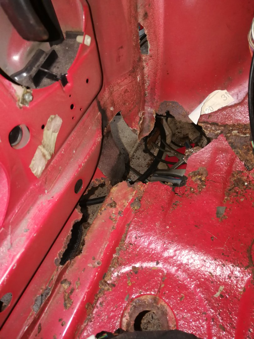

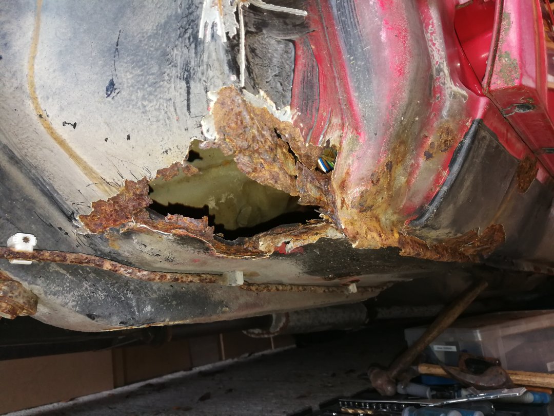

Onto the passenger front floor pan / and sill sections photoshoot
All the rust / damage along the sill area has been caused by improper jacking up of the the car.
The floor turned out to be a lot worse than originally anticipated, you never know what lurks under the soundeadening
