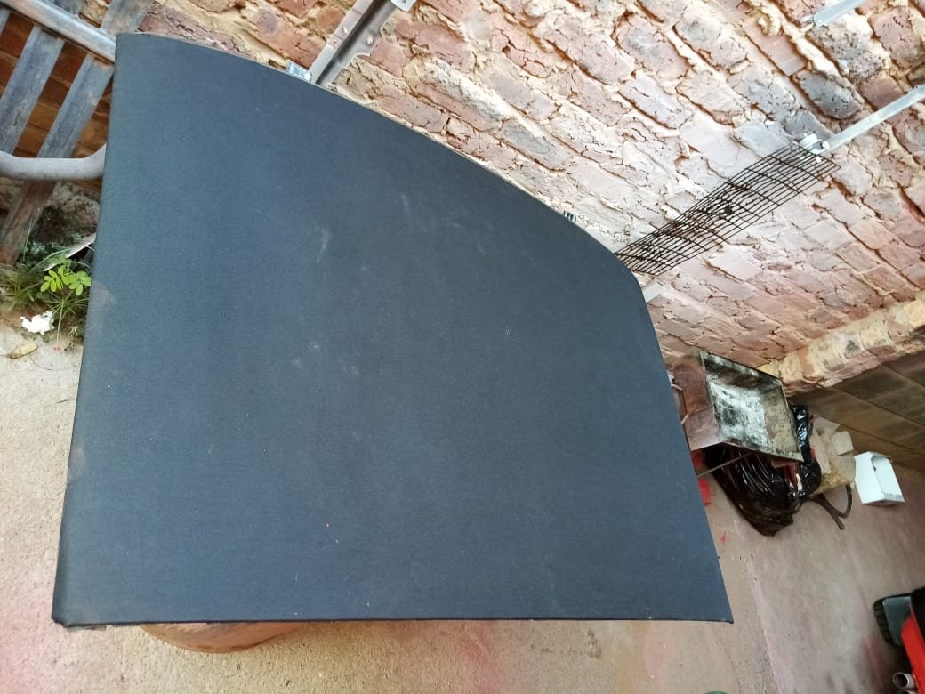

I have TC2 Baur that have been working on for a while now. I am almost done with it but find myself stuck with the targa piece of the roof that seems too soft and saggy. Is there a way that I could DIY to refurbish or repair this part of the roof?
I don't want to spend lots of money on this part if there is a way to fix it.
Your honest opinions and advices will highly be appreciated.

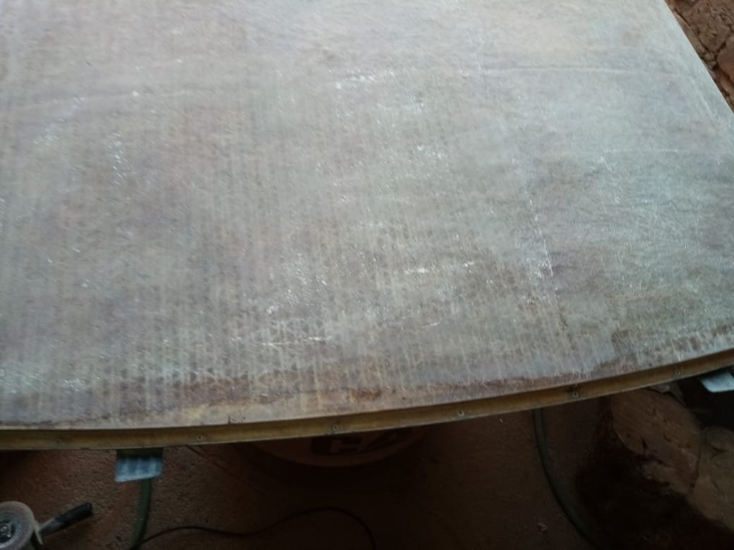

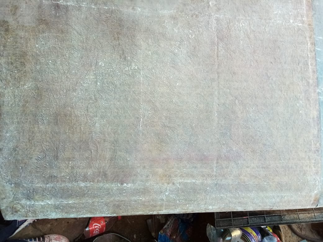

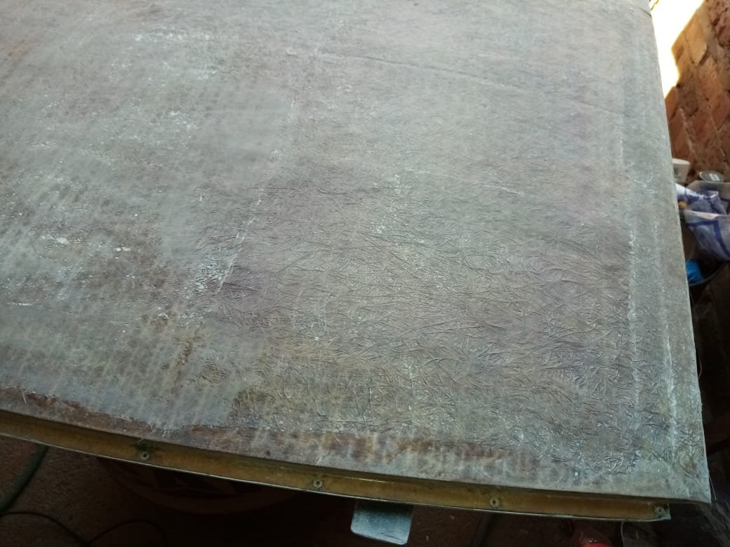

Thanks for the response. Unfortunately I did not take pics of the targa roof piece before I started working on it, but I will rather send pics of what I decided to do of which I stripped off the canves material and from the looks of things the targa top is made from fibreglass strends and so I decided to strengthen it with fibreglass.
I took a chance and hope that it will work. I will send you the pics and also let you k ow of the outcome.

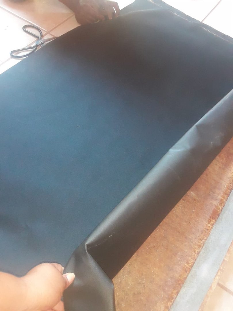

Hi Mart

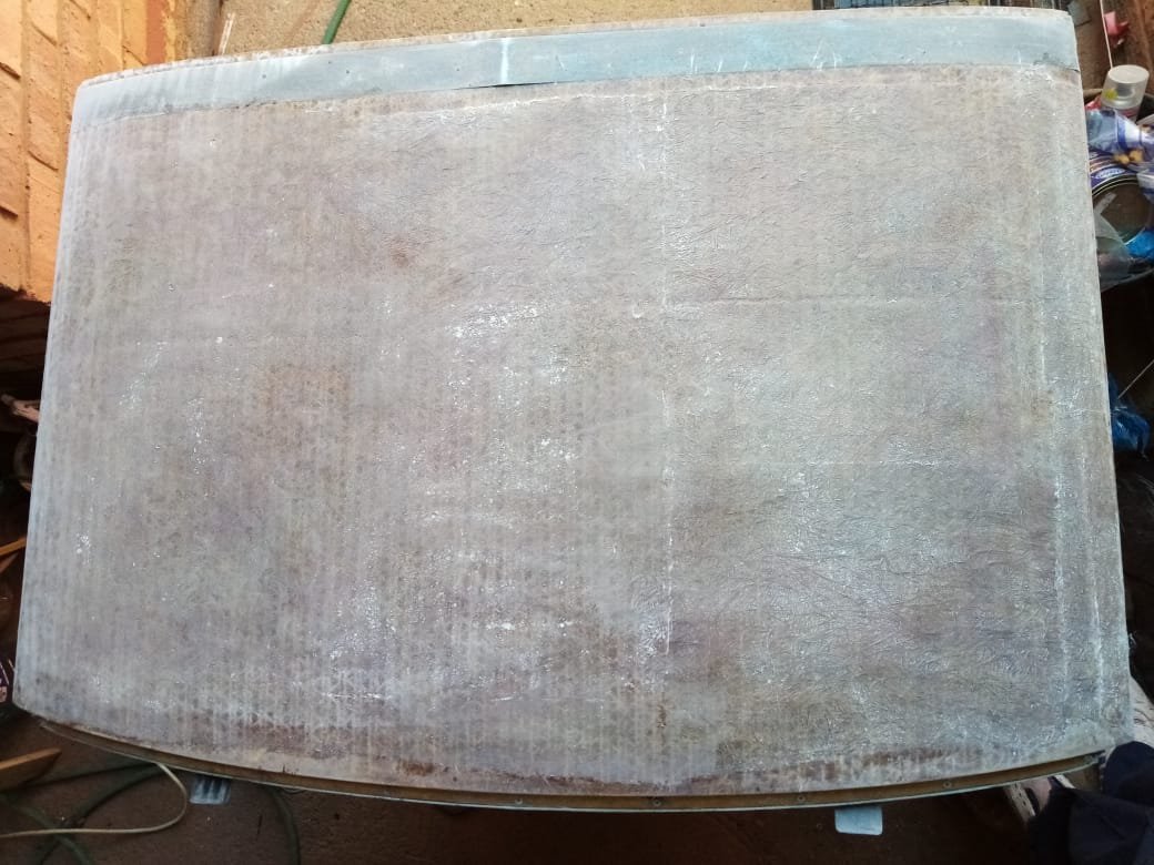

On the pics that I have posted, I had already started working on the targa top
The following are the steps and things that I did to refurbish my Baur targa top
1. I added fibreglass sheets on to the top
2. Sanded it down for smooth texture
3. Applied adhesive contact glue
4. Laid the canvas on top and it came out very
well.
I will post pic of the finished top tomorrow.
Cheers.
well.
Cheers.

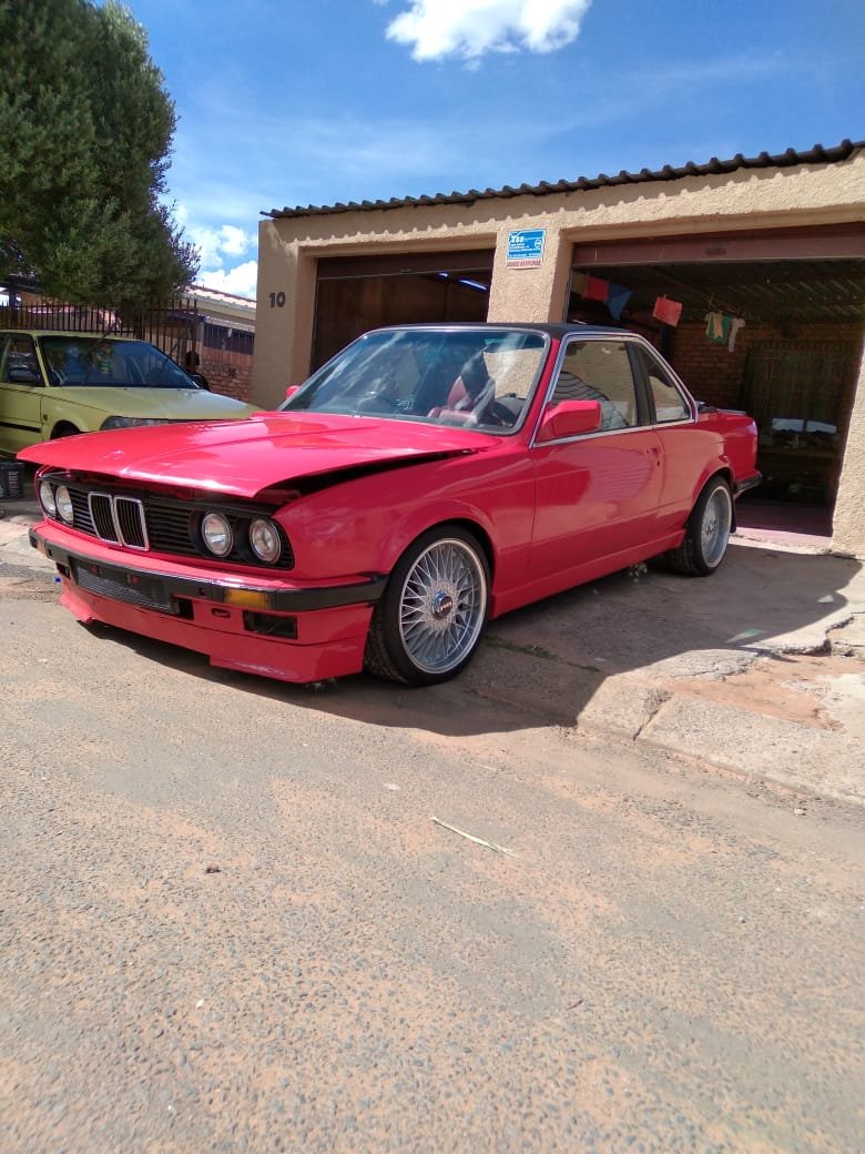

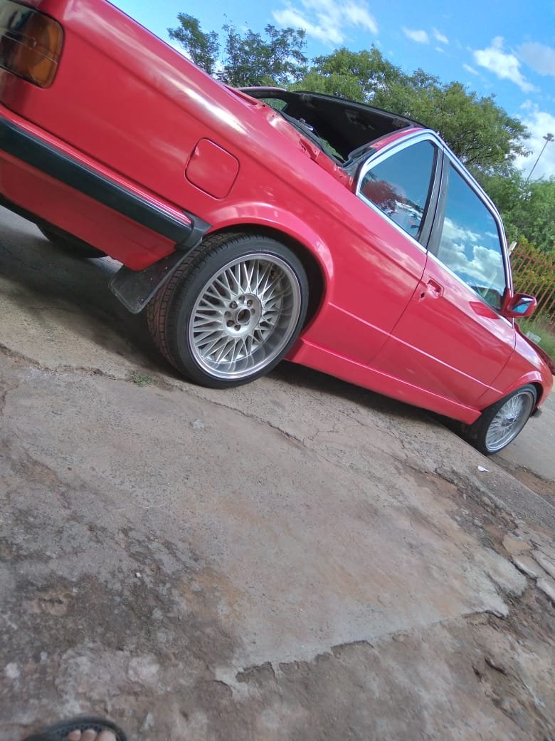

Anyway today was my birthday and decided to take out my unfinished project that I have been working on for quite some time now. I think Brian Moore might remember when I first joined the group and had a problem with my car not reving up. Anyway I included some pics to show progress thus far

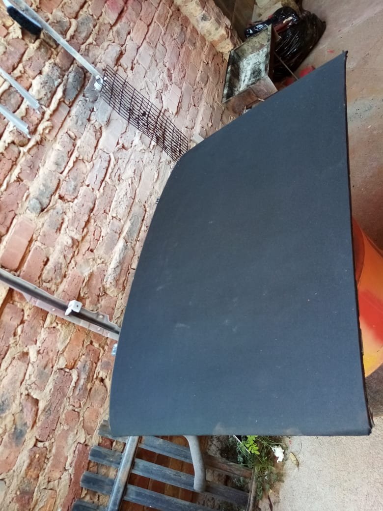

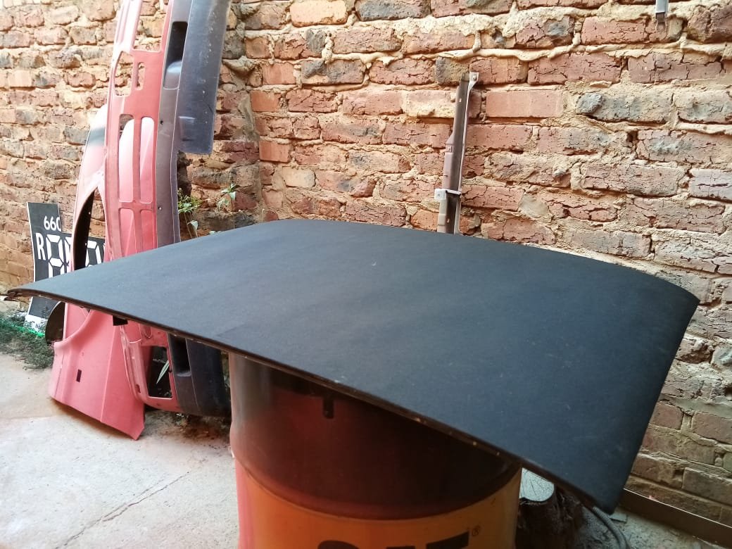

I n this post I am sending my finished targa top (fibreglassed and covered with canvas
- Attachments
Carlitto76
- Posts: 23
- Joined: Thu May 21, 2020 10:08 am
Hi Mart

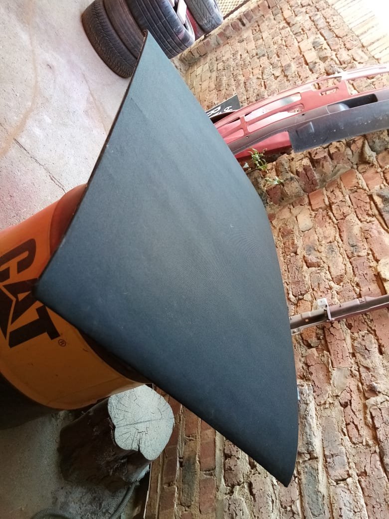

In this post I have decided to send pics of my finished targa top (fibreglassed for reinforcement and covered with canvas material

WOW very impressive mate, do you have more pics of you doing this ?
