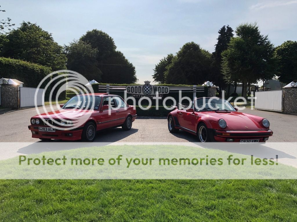

I also managed to share a few days out with my dad in his 930 Porsche at Goodwood.
And in June I raced at Silverstone with the BMWCC Racing series and the Popster was on show on the car club stand. It was really cool to have the fleet together.

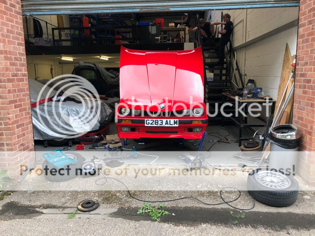

I used to be so keeno at taking zillions of photos and I have been so lazy with it the last few years. The front valance on this car had been messed about with at some point as it didn't have the proper stone chip layer under the paint, it was a funny colour that was also falling off. The brake ducts were also a different shade of red. When I had the sides of the car done, I had the new front lip done. All in all this meant the front of the car was now a few different shades of red. FINALLY I pulled my finger out and removed them to go to my friends paint shop. Now it did take about 3 months for me to get the bits back however the front end is gleaming now and I am so chuffed with it. Couple with my freinds at CarEd Auto Detailing the whole car looks amazing. I popped my AA relay retro badge on the front grille I picked up from an antiques fair and I can't wait for our little E30 run up to the lake district in just over a weeks time.
While the front end was off, something has obviously happened to the front of this car at some point as the fog light, indicator and OBC temp sensor wiring have all been butchered with a combination of choc blocks, insulation tape and some wires were even just twisted together and wrapped :roll: So I will be needing to buy some new plug tales and soldering and heat shrinking everything back together to make it right again.

:D Thanks. I am in the process of figuring out the best way to sort the mess of the front light loom. This will be easy, however it is the radio/immobiliser wiring I am itching to rectify that fills me with horror :boom: I've bought a Nakamichi stereo from a friend and have very little ICE knowledge. Coupled with the fact it is a rats nest of chock blocks, bullet connectors, cut wires and christ knows what else waiting for me, i am dreading it but also excited that it will be tidier once done.
