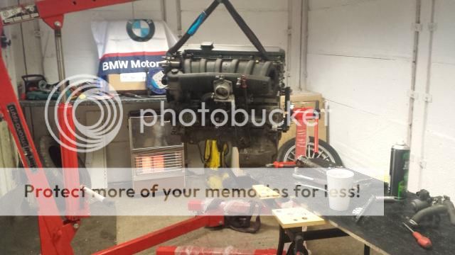

bit of an update , i've got the spare m52 in the garage and mounted up on the shiny new engine stand ...also managed to get the crank nut undone on the m54b30 block so i can now rob it's internals ..... took the block to a local garage who's big windy gun made light work of the crank nut ..... free of charge :D
list of needed parts are
valve stem oil seals [ got ] elring
both crank seals [ got ] elring
head bolts [ got ] ecp
con rod bolts [ got ] BMW dealer
head gasket [ got ] GSF premium
may not need these parts but i'm going to look at prices anyway just in case...
main bearings
big end bearings
piston rings
the plan is to install the b30 crank/cons/pistons providing the bores don't need a re-hone on the m52 block and check clearances to see if i need to buy the other parts .
if anyone can see owt i've missed or offer some HELPFUL advice feel free to chip in ....

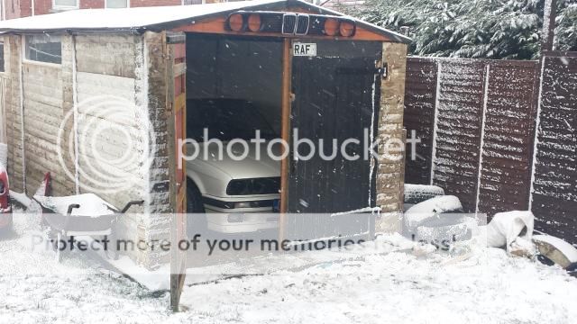

cute garage.

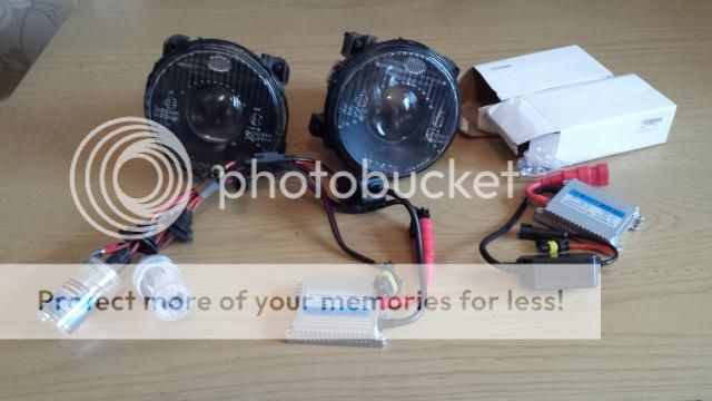

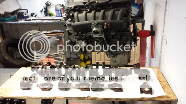

small update ...the m54 block has been pillaged and my bullseye hid's are ready to fit :D
spare m52 project b30 engine with m54 internals ready and waiting
m54 block and other m54 parts scrap pile
changing my smoked smiley's with these bullseye ones and HID kit ... much prefer this look .
sidelight led's ...i'll probably only have them plugged in for the mot as i just want the projected main light illuminated and the side lights will spoil the look i'm after . i just ordered some of these 130w intense white bulbs for the high beams ......blinding :wink:

magpie wrote:. i just ordered some of these 130w intense white bulbs for the high beams ......blinding :wink:
http://www.ebay.co.uk/itm/141167243546? ... EBIDX%3AIT
You'll need to change fuses 1 and 2 to 15A, and replace the wires from these fuses to the headlamps and the earth wires from the lights to the inner wing with at least 1.5mm2 wire, and preferably 2.5mm2.

magpie wrote:small update ...the m54 block has been pillaged and my bullseye hid's are ready to fit :D
Love the old skool gas heater :cool:
Initial glance at the picture it looked like you broke the con-rods :mad:
Wed Dec 10, 2014 8:24 pm
i numbered them but didn't need to :mad:

thanks for the warning 8)

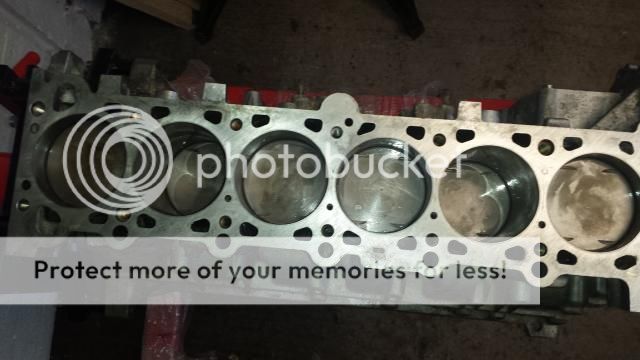

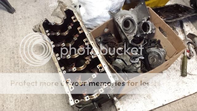

had my good man Craig drop round to strip and inspect the spare m52 which we are both now not so sure this was a good running engine going by all the blocked water channels.
i doubt this would of lasted a week in it's current state ...
not the end of the world though it just needs a good clean out , all the head bolts came out ok with no stripped threads so hopefully it'll go back together the same .
i found an engine rebuild place not far from me who will be putting the m54 crank back in the block using Karl Schmidt mains,big ends and rings for £225 inc vat for parts + his labour which won't that much . it looks like the block is getting a re-hone just too keep things sweet .
Craig took the cylinder head home to do the valve stem oil seals and i'll be dropping the block and other parts off on Monday .

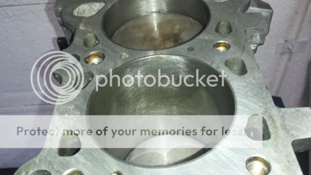

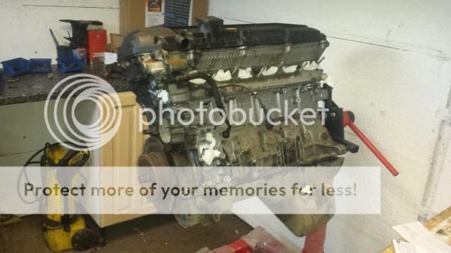

got the engine block back earlier this month fully built up and re-honed with KolBen schmidt big ends, main bearings , piston rings .
ECP elring and febi crank seals also new BMW con-rod bolts .
freshhh!
Honed in ....

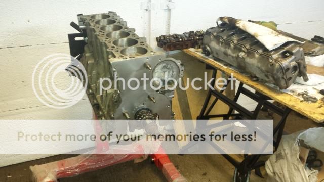

sat looking pretty waiting for the cylinder head to arrive .... howay man Craigeeb pull ya finger out :teehee:
after a strategically placed rocket had been lit ....Craig turned up bearing gifts ...well not really , just my cylinder head with all the valve stem oil seals replaced :D
two hours later and all the worry is over , it's finished as far as i can go until i pull my healthy m52 out and strip it of the other parts i need such as sump, loom manifolds etc , i've stuck an old e36 sump on for now , the cams were drizzled with oil before the engine was turned a couple of full revolutions .

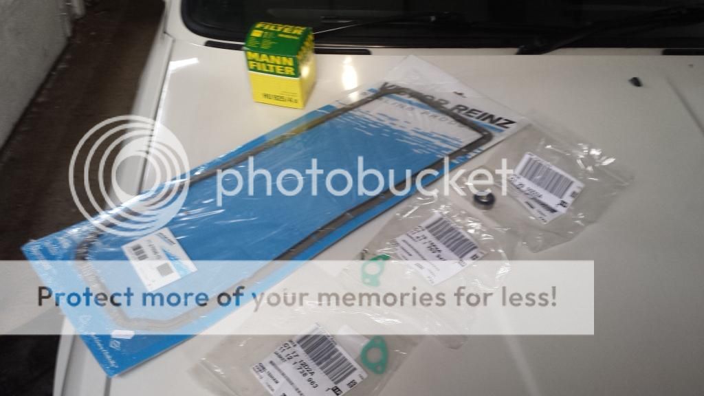

new sump gasket,oil pic up and the coolant stub on back of block gaskets + e36 evo spigot bearing and oil filter waiting for me .

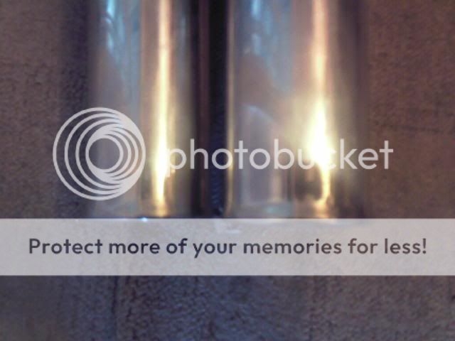

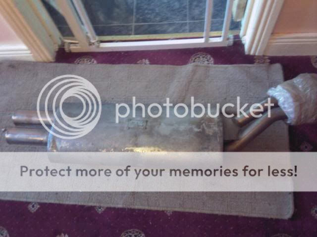

i'm thinking of running a new zaust and this one looks ok
http://www.ebay.co.uk/itm/270704893083? ... EBIDX%3AIT

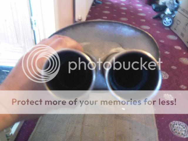

but i'm considering having a custom s/s one 2 and a half inch single bore with same sized twin exits as the scorpion ...i want some kind of refined noise over the scorpion if ya get me

If you can find a used BTB for sale it will blow your mind away. It honestly sounds like standing next to a world war 2 spitfire. Small kids run away crying, old people have involuntary bowel movements and people shelter undertables thinking there is an earth quote. They are absolutely flipping epic.
Sun Feb 08, 2015 11:02 am
i sold a good looking twin exit s/s back box i bought off sweep to eko on here for his mugello turd that i never fitted or heard it's soundtrack so to speak ...anyhoo the said back box is currently wedged up pacers back passage still fitted to the mugello rot-ter so there is hope i might get it back and he might get the spanners out and frag it lol .....
