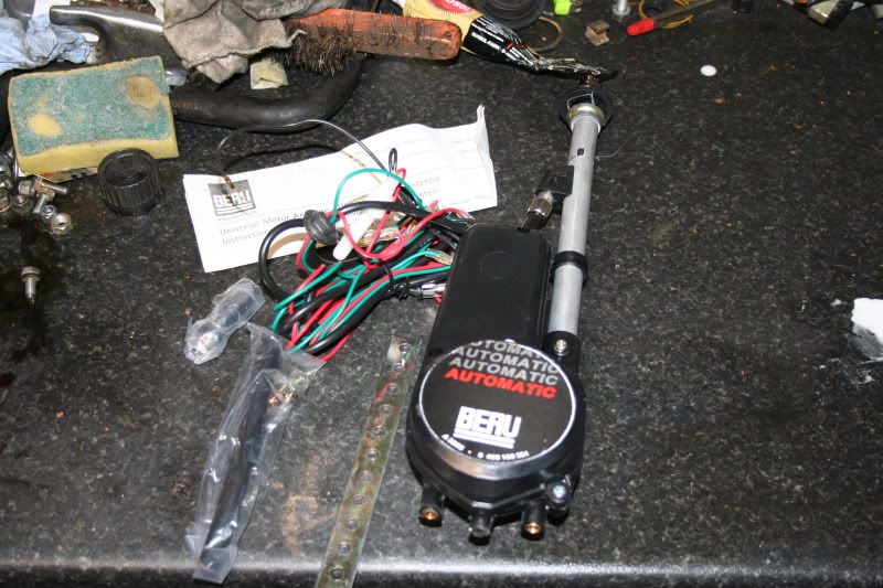

So talking to blitz at ace last month he said he bought a new aerial for his cab in chrome from euros......
They also still supply in black, 8)
Fits noice, i've pulled the wires through the rubber grommet at the bulkhead into the car. Bit of a random purchase but they might sell out?!

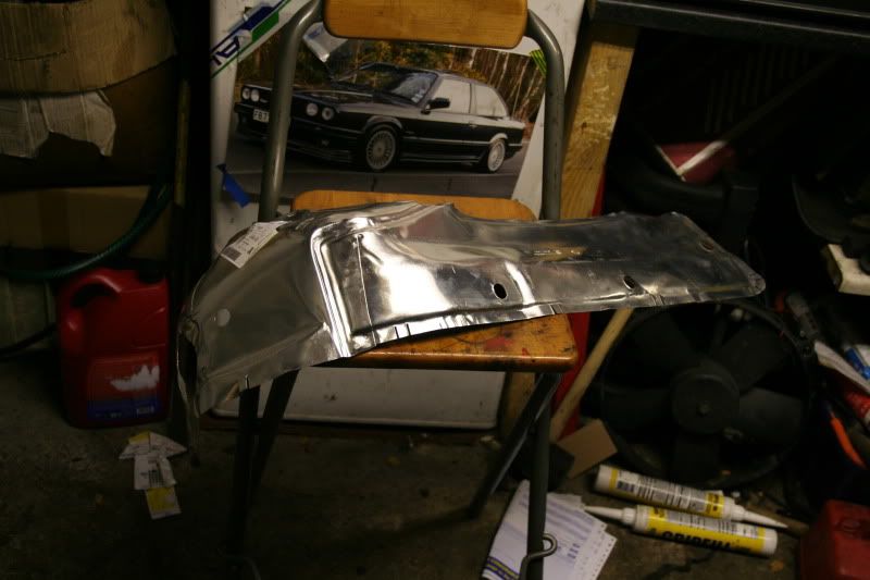

Tropical spec radiator. Now this has been an epic saga so far i think. So you've noticed like i did that it has the transmission cooler for an auto. I thought well i can get over that. so i fitted it.......
Horny i thought, the new fan shroud and top hose will finish it nicely!
its f**king broke on corner where the fan shroud fits so i'm not having that. The broken bit wasn't in the box either so someone knew i expect.
So this all started a few weeks ago, i went into ecp to see if they infact sold them. They did and the chubsta at the till said there is one in stock in wembley, the last one. So i left it a week and was chatting to Henry at the Guildford meet and he said go and buy it! Don't take chances. This was resonable thinking but a week had passed now. So I went in after work and guess what? its sold none left, so i said f**k it. Guy says there is actually 1 more but its in the Belfast branch, i said can you get it? No in a word. Belfast are difficult to deal with and don't like sending parts off for interbranch requests. They go to Wembley HQ first. So some more swearing and tell him what its for etc as he told me i don't need it either bla bla! He says i'll ring and try and get it over but don't hold your breath. I'd also ordered a recon 90amp alternator which would be in the next day. Next day comes and good news they'll send it over he tells me. Horay i thought. It will be in Aldershot for Tues.
I go in tuesday late morning, but its not here but will be in the afternoon, ok. Go back still not in so twice in a day are you guys mugging me off? Thursday they promise! Thursday comes and no rad still when i walk in. Friday and a phonecall to say its arrived! So we end up to where we are now, so i took it back. They said its the last one they're not going to get anymore in. Well they are as they've got one ordered for me after i showed them the damage and auto wrongness. So i think there will be a batch coming in from Nissens/Behr in 8-10 working days. I await with baited breath. BMW wants £370 for a tropical rad and the ECP one was £106. So worth the aggro imo. The fan shroud was £15 and the top hose £30 so i'm not chucking the towel in yet on this!

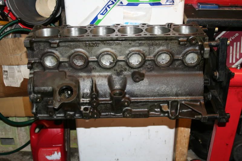

This is the e36 loaded up for a trip to my old mans with his engineering measuring type bits or a mikes but i can't spell that lol. Micrometer is the correct term? Anyhow thats crank in the green towel, 6 slugs and the block
The result of it is this. Bently manual covers the spec sizes in imperial. My old man works in this and the older folk on here will prefer it! so its all in inches and thou and tenths.
The block and pistons are out of spec. theres a 7 thou difference between the bores and pistons. The wear limit is just under 5 thou. Its the pistons i have that have worn a bit. They're all around 83.895mm. The bore on No.5 is all scratched up to fook from the last bodgers that had a go at fixing it.
Now i've binned off the Original pistons and crank. The crank needs a regrind and the pistons would go again but i had better! I bought around 6-7 years ago a complete Alpina 2.7 bottom end of another zoner Jit for those who remember! This had issues but minor! So we're using the crank and pistons and rods from this bottom end which came from an 88 E reg dolphin grey facelift 4 door auto that was broken for rust issues about 10 years ago. I've alot of the cars history and also found out it had covered at least 170,000 miles before it was fragged.
What had happened to this engine was the crank nose bolt came loose for some reason i don't know about and this happened. This happend to jit who bought the complete engine for his minty old 325i cab. After this he had a stock 2.5 bottom end fitted and the alpina top end rebuilt and sold the car. So there was this bottom end sitting in his garden with no sump which his brother had nicked for his sport, usual speed hump and 60mm drama and aholed sump. This is where i came into it. The block had rusty bores from being outside. Pacerpete has this now. Sacrilege to such an engine!
so this engine suffered some valve piston action and a mullered woodruff key slot. As you can see i've had a new slot machined in so thats that sorted. The front pulley still fits ok also!
The other great news is its still in spec. So standard size big end shells and mains. Which will be "whites" This is bmw engineering for you. There are 7 journals on a 6 pot crank they read like this

So back to the block, and alot of thinking and weighing up prices etc its £1200 for a new set of over size 1 alpina pistons. Or you go the custom route for abit less. I want to retain the original block for obvious reasons. Changing the block to me is like a reshell on the donk. if you get me. The head and cam was missing when i bought the car and no serive history to indicate where they went. Probably cracked a head like every C2 i've ever know well has at some point. Soooooo i've got to keep something! So the route is getting the block bored out and sleeved with new cast iron liners. The job will be a goodun
So although the pistons are a touch worn i'll have brand new bores in the OE block and a f**king tight bottom end again i hope!
It breaks down to this liners £35 each,
bore block out £100,
fitting liners £60
rebore and hone £120
reface top of block £75 - i can save this as my dad can do it, he'll also reface the sump side too.
So thats where i'm at i just need to find the time to drop it off. Which i'm hoping to do before my wedding in 2 weeks!

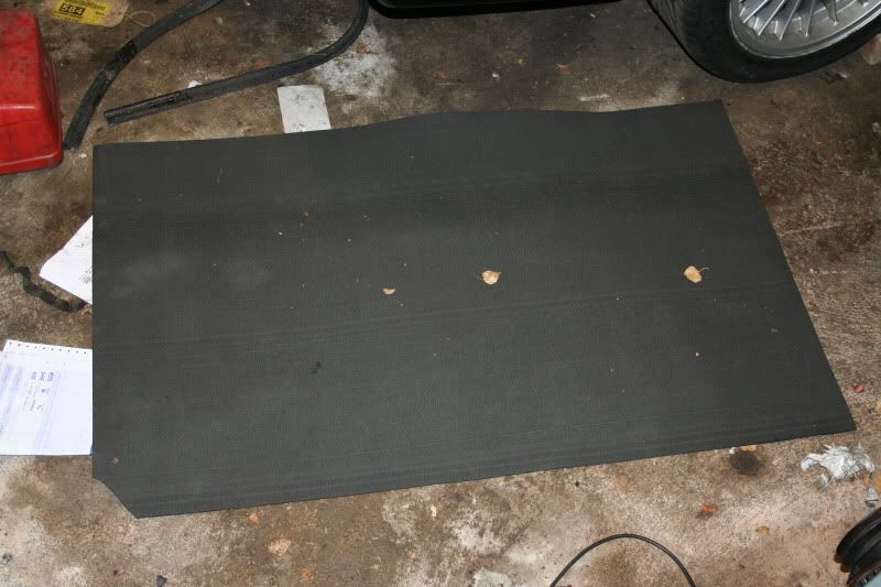

You'll notice a complete lack really of sound deadening here. E30's aren't the best in this department. So i thought this might help
Its light too. i've had it lying around for a while. I ordered from BMW some new clear plastic to seal the doors up like the factory did behind the door cards. And a roll of this white stuff turned up. how strange it was but took it any way as i I thought i'd put it to i hope good use someday.
I'm not sure if the patch on the front door will get soaked every time the car is washed as there are drain holes in the corners of the doors? And if it does its a bit of a waste of time. So not so sure on the front ones now. Its if the outer glass rubber weather strip lets water down into the door to drain the rain water out etc.

'Going the extra mile' usually takes up 90% of a days work on the car, but this is the difference between doing it right and just chucking it together 8)
I wouldnt leave that white stuff inside the doors though mate, IMO all it will do is hold damp.

i'm thinking the same, i think i'll get the hose pipe on the passenger door and see how wet it gets inside.
Ordered some ICE wiring today along with some more sound deadening. With this lot in i can refit the carpet. Which will be epic and give me lots to do!
Posts: 28640
Mon Nov 22, 2010 8:02 pm
You need to consider condensation also, the door is expected to get damp which is why they fitted the plastic membranes :wink:

Dans right Si. I'd get it out.
Mon Nov 22, 2010 10:27 pm
looks like i'll be taking it out then. :o

yep, whip it out, amazing how much water passes through the inside of the door... 8O

I've aimed a jetwash at both my doors from varying distances with door cards off so I could see inside the doors. Passenger door is all original, drivers door 100% all new seals, trim etc etc.
Lots of water drips in. And if you've overdosed on the waxoil, your drain holes will be clogged?
I think that fabric is for lining your door cards as I have it on some spare cards.
In short, it will get very soggy.
The vapor barrier film is important here too to keep moisture away from your door cards and making them damp also - they're only cardboard after all.

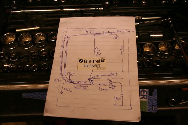

Here is the start of the "ice" well 2 phono leads and long length of some speaker wire. The head unit i'm going to use doesn't have an internal amp so i need the phonos as i understand to run to my external amp from the headunit. Big stuff this is for an icetard like me.
A nice lump of sound deadening. This is for the rear footwells and maybe the rear shelf like M3's and other e30's seem to have? Mine doesn't for some reason.
So if i get this lot in and my ice wiring we are ready for some carpet action to occur! Which in turn means i can get this lot in

With the heater in the dash can go in! So we're at a special stage where it will end up with a interior which excites greatly!
Heat sheild i've forgot to fit which fits around the sterring column, and is exhaust side of the transmission tunnel/floor pan area. I noticed the old one hanging up and it twigged, but it was not shiney enough!
lovely leather gaiter from Theo so cheers again for that dopolous was here when i got home.
This was a special day people. me and car! today at the machine shop to pick up me block and pistons!! I had another answerphone messege to say it was all done, from honeymoon. (no other texts or messeges after 10 days of having my phone off lol) They originally said next year so i was pleasantly surprised! Battled the 70 mile trip through the snow to get there this place is near cirencester and came highly recommended through a contact of my dads
In the boot ready for home and a bit more traction but the weight out of the wallet emptying cancelled it out!
So its been chemically cleaned or dipped before anything else started
a major improvement on its own from this oily,rusty mess!
slugs safe and sound they were all numbered on the inside of the skirts, but i guess this makes it easier for them!
A nice clear shot of the liners
check out the hone mofos! I've stripped alot of M20's and they never ever looked like this even the best!
The money shots for proof of OE alpinaness. From looking at my touring photos of that engine and its original build sheet it would appear that the 4 digit number stamped is alpina's own engine number. The long number is what the man at sytners did. So thats cleared that one up for me. I'm guessing that if i contacted alpina direct they will have record of the engine being built. I don't think this is the number that should be stamped on the head. But at least this could let me find out i hope?
I'm thinking i might contact sytners now and source a copy of the build sheet for this very car seeing as i have all the other bits to complete its history like the service book anyhow.......
Now people slag off liners and say they can sink this that the other. they told me as Alpina are performance engines they did this intentionally. So they have left a few mm of the original bores at the bottom for the liners to sit on to ensure they'll never sink. I like it. Theres a tiny lip on some of them but the piston skirt doesn't travel anywhere near that low in the bore so it doesn't matter. The liners are fitted in an interferance style. Where i think they cool the liners down like really really cold and then fit into the block. when they expand when they warm up this is what holds them in place. The liners are a high grade of iron also to match the block material i think.
Where my pen points is so i learnt today an anti expansion ring as such cast into the piston. This is to stop the piston expanding too much when the engine is up to temp. This allows a very tight tolerance to be run on the bores. Factory spec is 0.01mm to 0.04mm. or 4 to 16 tenths on imperial. So this is what they have done. The stock 2.5 M20 pistons have it so i guess all bmw and other engines feature this.
To cap it off as the reciept says

So 6 fresh bores suited to each slug, i've now really no money to continue! how strange this hasn't happend before has it?
Now alot of people have said don't go this route but its the original block. To me this the heart of the engine along with the head. If i had replaced this with a different one then to me its like oh the shell was too rusty too so i bought another and did a scuttle swap job.
Last jobs are to get the block painted with some new core plugs? Any ideas here? then the last job will be off to my dads workshop for a reface both ends of the block. I'll save 70 plus the VAT the other place wanted just to do the top of the block.
Next buy shells, rings, bolts and a clutch and send it all off to be balanced. You only live once.....
