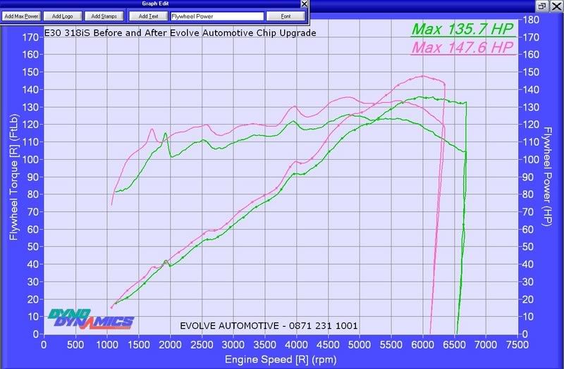

First and foremost many thanks to Arron Green (agreen) for volunteering his low mileage 318iS for the chip testing we are carrying out here at Evolve Autmotive.
The day started with the first dyno run at just under 136 bhp which is bang on the power for one of these.
We then moved onto testing a few chips.
The first test showed an abismal gain of 4 bhp when the quoted chip should have given an amazing + 18 bhp!
Had a look at some other chips we got hold of and compared them on our program and there was little point in trying them out as the ignition timing and fuelling values were pretty much the same and in some cases exactly the same (ie: Copies).
We then went about testing two of other chips which are under the Evolve Brand that had never been tested but the feedback was very high from customers.
We do quote around 7 bhp from one of these so we didn't really expect anything more.
To our surprise the gain was just under 12 bhp.
The second more agressive chip ws a little too agressive and we decided on not dynoing it at all.
Arron was with us all of the time and we done every test in the same way with intake and ambient temps very close to each other.
Graph of Before and after with the Evolve 318iS Chip:
On the road Arron gave the same feedback as others who have used this chip - considerably better part throttle power especially at low rpms, smoother power delivery and a noticeable gain under full load driving.

Excellent. Great gains in torque too it would seem. 8)

Cool, Amazing how much the low down torque is improved.
Any reason for the slight drop between 1500-2000?
It's good to see that the tests were carried out on a standard M42 that was running the way it should from the factory.

the slight dip at the bottom end on both curves is to be ignored, this is just a fluctuation when the dyno loads up.
From experience of mapping many cars including old and modern + 12bhp is pretty much as much as we are going to get. Any more timing and your really chasing a few horses which is not worth the risk.

Good to see the Torque and HP graph crosses exactly at 5250 too winkeye
Seen one or two that haven't :roll:

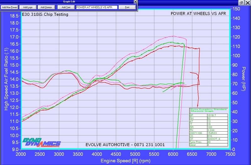

What were the wheel figures and the AFRs like Sal? This tallies ish to the gains I got using megasquirt to richen up the AFRs, although didn't quite get 12hp.

tim_s wrote:What were the wheel figures and the AFRs like Sal? This tallies ish to the gains I got using megasquirt to richen up the AFRs, although didn't quite get 12hp.
Hi Tim,
I can most certainly put up the wheel figures and AFR's, will do it tommorrow.

MY car is SOOOOOOOOO good now its amazing 12bhp what a diffrence the torque is the most impressive thats what you feel and bot do you feel it now
in answer to the question there is a gain all the way threw the rev range a really noticeable one the half thottle resonse has been transformed and under full load the diffrence is emense
the car is now smoother more responsive and alot more fun to drive wheater your pottering around or canning the tits of it thanks sal

Dave_M3 wrote:Good to see the Torque and HP graph crosses exactly at 5250 too winkeye
If they don't, check to see if the dyno has auto scaled the torque and power graphs, as not always you will see them on the same scale. If they are not, or measured in another unit, then they usually don't cross at 5251 RPM. It has to be BHP v lbs ft on the same scale ie starting from 0.
Hope this helps.

Come on Sal,
You can hardly conclude from one car that the chips you tested were only able to produce 4bhp and yours did 12!
Its more than likely the chips could have been issued for a different M42 as we both know there's plenty variations whether the engine idles or not!
I would not draw any conclusions from one car on your own Dyno with your own chip!
Also why would changing the TB to a BBTB not need a chip to compensate the extra air now entering the engine?

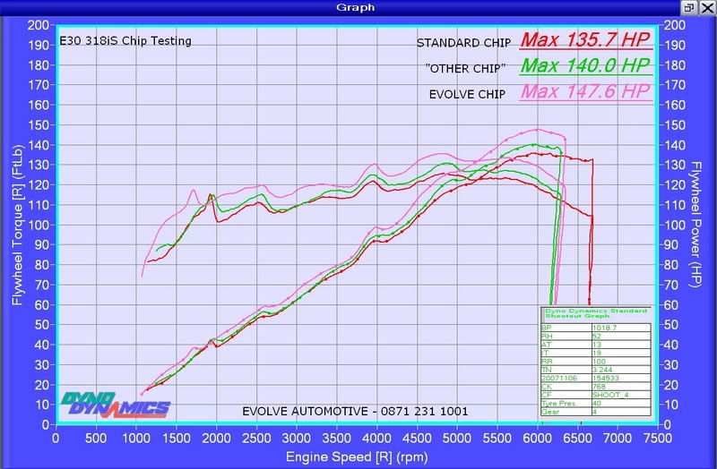

Here are the graphs of standard vs "other" chip and Evolve Chip.
Sheps - I hope the graphs show consistency in our testing from flywheel to power at wheels and also answer your question. As for putting the same chip in two different cars and getting two very different results - that only really happens when one of the engines is worn out somewhere or something is out of spec. The whole point of us asking for a lowish mileage engine was to get something that was good and in this case it put down pretty much close to what we expected.
Demlot, as for testing on different cars - not really required from our point of view. We remap loads of ZM's, E36 M3's, E46 M3's and we always get within a few percent of the gains on different cars. Why should this be any different on a relatively simple 318iS?
If anyone suspects our results to be bodged in any way then bring down your cars and we'll do the testing again and Ant can use the dyno. If the tests are consistent (and they will be) then you'll be handed a bill for our time and dyno time.
It is not in our interest to BS our figures. Alot of people buy chips from us and anyone could go to a dyno and have a before and after test done.
The graphs:
Note: AFR's on standard and both tuning chips are very close to each other. Most of the changes that are made are to ignition timing as the fuelling is pretty spot on from the factory.
After looking into the various files we have here it is clear the reason why they don't make much power is because the ignition timing is way over advanced. Not to the point where the engine will detonate but not far off.

ShepsEvo3 wrote: Sal, what I am interested in is what was the maximum increase in power and at what REVS over standard was the chip that only gave another 4BHP at max power?
From the above graphs you can see that the "peak" power gain was only 3.3 bhp. At around 4750 rpm the "other" chip gives around 4bhp at the most.
