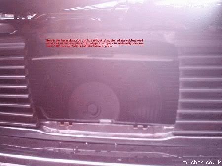

I have one of these on my IS, fits perfectly to a IS rad mounted on a couple of air box rubbers, nice a quite.
Car never goes above half way, even in Hot central london traffic
I *think* the are made by kenlow......

Series 2 fits in front of the rad.
I cut some lips in the cowling (infront of thte rad) just enough to mount the fan. I used airbox rubber mounts which you can put bolts on either end.
Mounting take 10 mins!

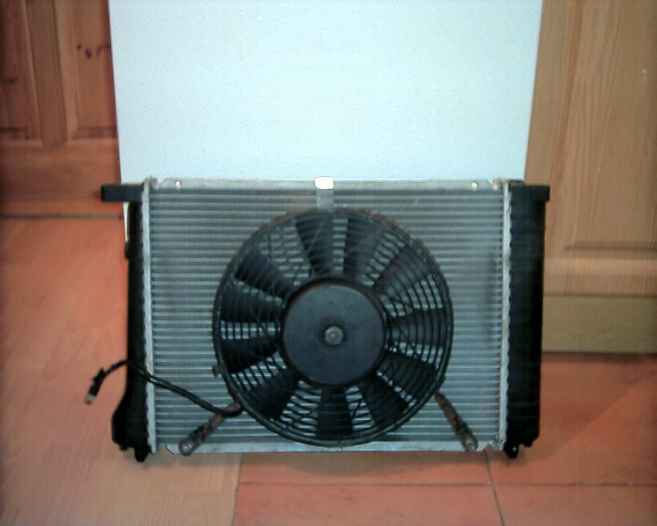

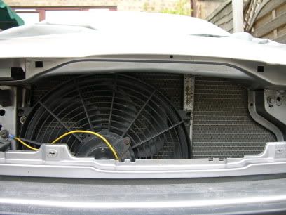

pic of mine.
On the car :
