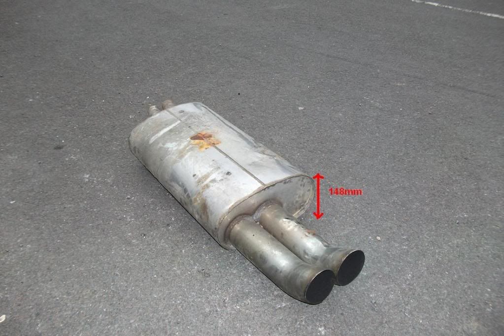

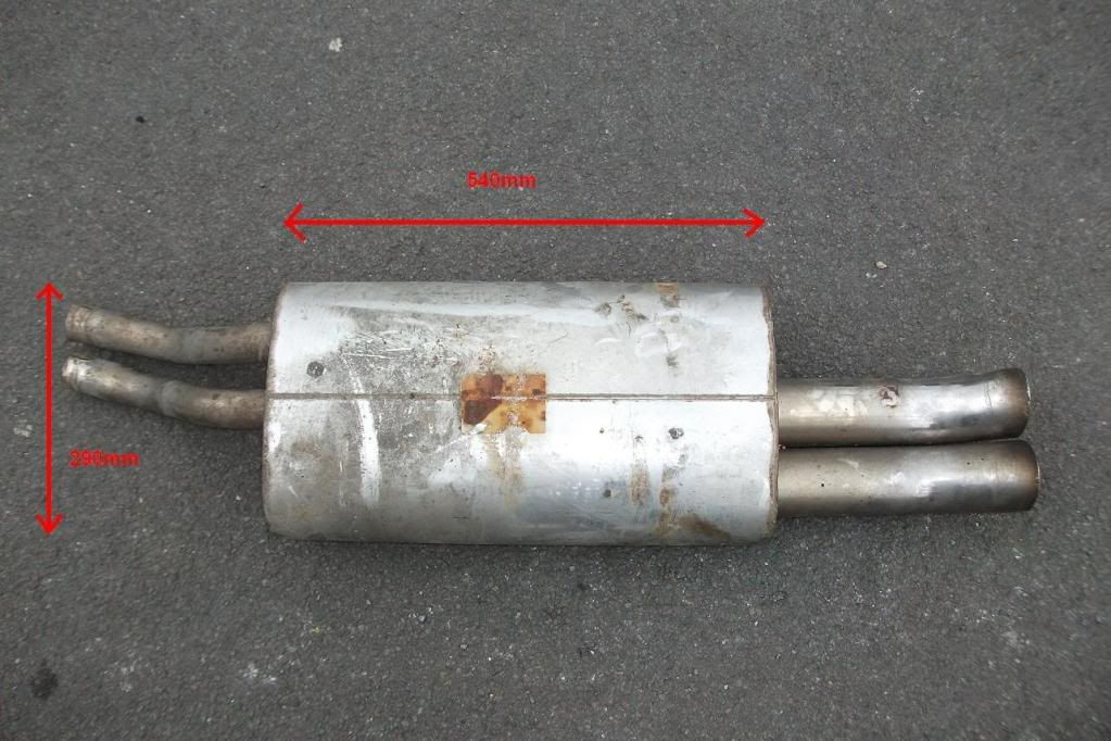

cheers guys, turns out the scorpion is a lot bigger than an oem system.
Just to give you an idea of the size of a scorpion if you dont know........
540mm x 290mm
148mm high
Looks a bit manky but looks like il have plenty of time to polish it up waiting for parts :mad:
I will try scorpion direct then i didnt think of that and the price seems good, but Does anyone know if all scorpion 325i backboxes are the same dimensions as i beleive the DTM is obsolete now.
