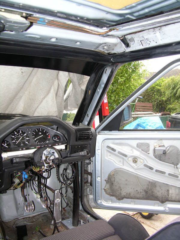

Not the best pic but hope it will do...
Had to take the visors off and the door pockets..

ed325i
Posts: 4146
Tue Feb 20, 2007 7:28 pm
Thats what I wanted zaust :wink:
I think if I take the windscreen out and get a hole cutter in a drill and drill 2 holes in the dash I may be able to feed the cage through.

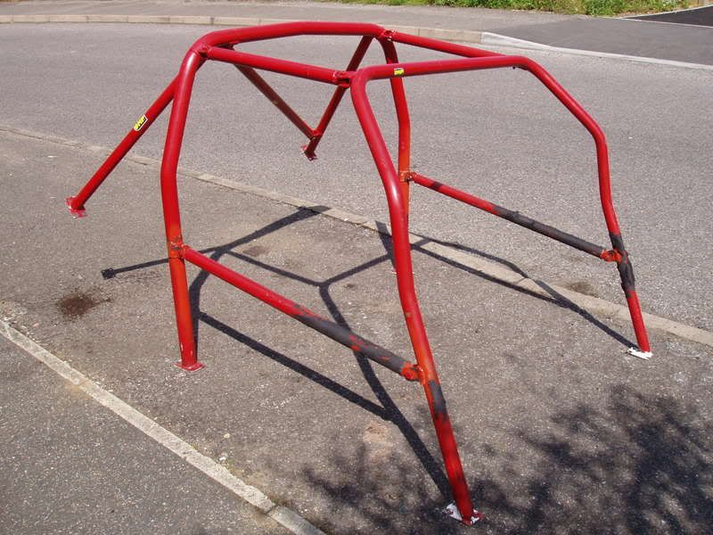

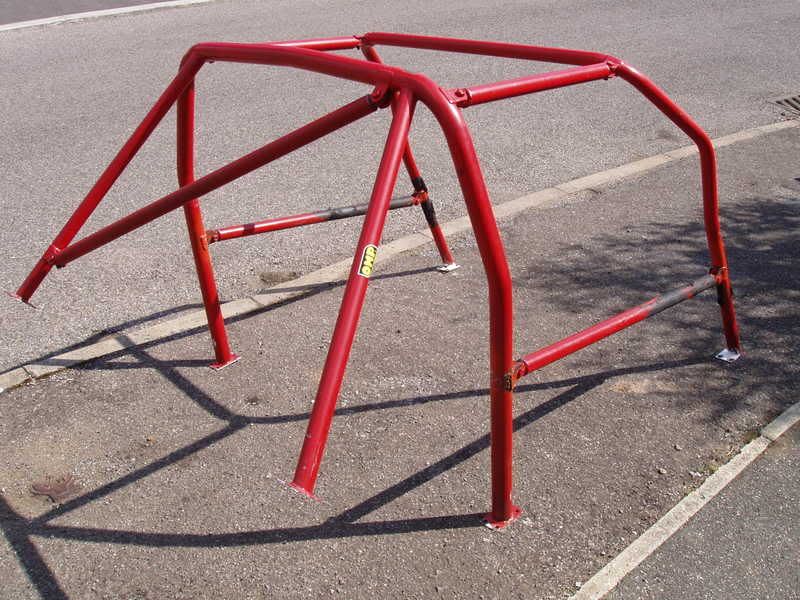

Here's some pics of my O.M.P. cage before and after fitting.
I did have to remove the glovebox (it wouldn't open so just added weight!), the sunvisors, hence my council sun-strip! and I had to turn the light switch panel upside down - which was a little fiddly!

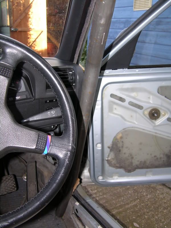

Here's ours -

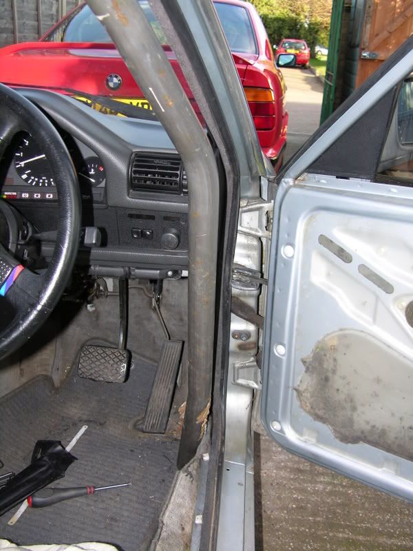

ed325i
Posts: 4146
Wed Feb 21, 2007 2:49 pm
Thanks for the pics it a great help.
I have made mine like this. Just got to make the other side.

northloop
Posts: 944
Joined: Wed Aug 16, 2006 11:00 pm
Thu Feb 22, 2007 8:23 am
The type of cage you buy will denote whether you need to go through the dash or not. It will depend on the dog leg at the front end.
Mine goes through the dash to the floor, then through the bulkhead to the suspension legs. Another bar goes straight through the middle of the dash from one side to the other. It's a pig to fit, but will be good in the end.
I would suggest that ones which go through the dash will be stronger.

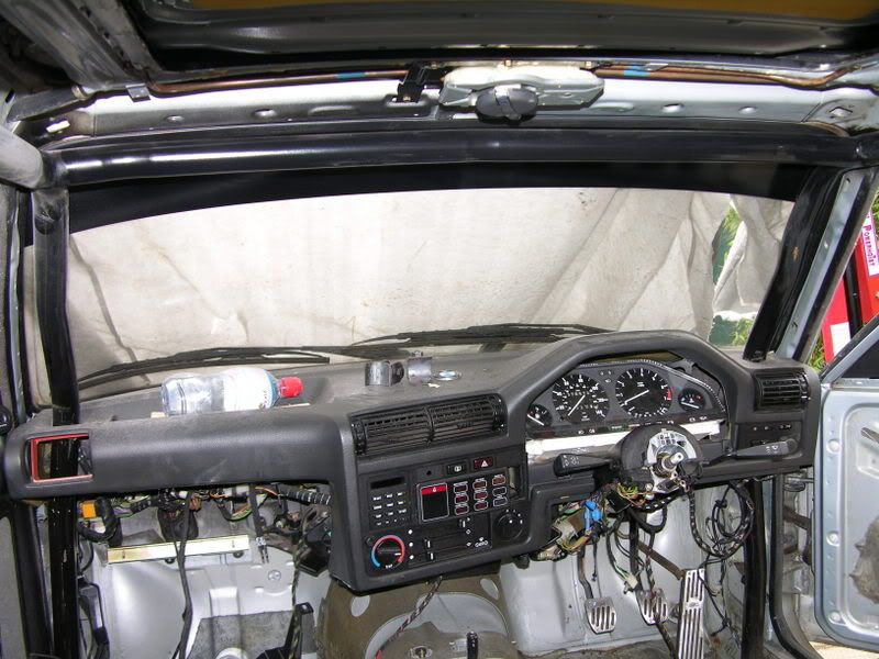

ed325i
Posts: 4146
Sat Mar 24, 2007 7:12 pm
Well I decided to go through the dash :cool:

Whats that in the middle of the dash where the sterio usually goes?
Rosc0PColtrane
Posts: 9757
Sun Mar 25, 2007 9:54 am
check panel cotty
Ed, is there anything you can't do??? Or are you just THE engineer??
I wouldn't have been surprised to read that you bent the metal yourself!!!!
ed325i
Posts: 4146
Sun Mar 25, 2007 12:27 pm
Didnt bend the pipes but had to make it fit as the cage was made for an alfa 146.
I just hate paying out money for things I can do :)
