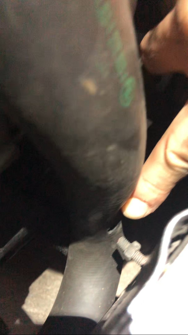

I did some routine maintenance recently and noticed that the lower radiator hose was very poorly routed. First, it is crushed between the top of the alternator and bottom of the air box. It also is directly touching an exposed bolt on the chassis which leaves it prone to puncturing.
I checked the part number on RealOEM and it came up with 11,53-1278925 which matches the number on the hose installed. It just looks so wrong and awkward that there must be a different hose for the 323i.

I took some images too which give an idea of what I'm on about.
Routing of the hose over the alternator (MAF removed)
Damage caused by chassis nut
Yup, looks ass about face to me. Worth a try :D
