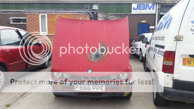

Check the fuel hose connections at the Fuel rail and pressure regulator, these are prone to the rubber hardening due to heat and can leak when cold but seal up again as the engine warms up, provided it hasn't caught fire by then.
Have a good look under the bonnet with a cold engine start.

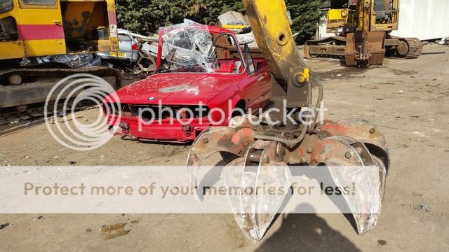

Fri Oct 27, 2017 11:27 pm
you don't want fuel spraying on the alternator
RIP 325i cab :eek:
