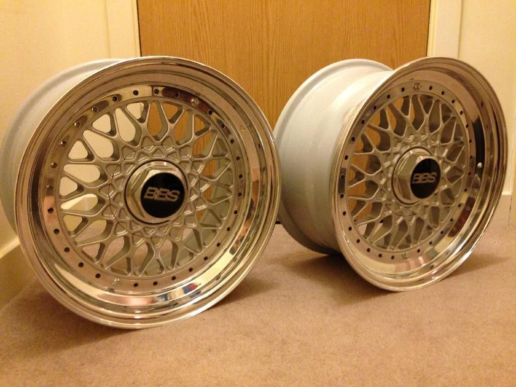

So today I started to split my BBS RS's as they look a little tired, gonna order up some new bolts and valves, have the centres re sprayed but polish the lips and spray the barrels myself just to keep the costs down.

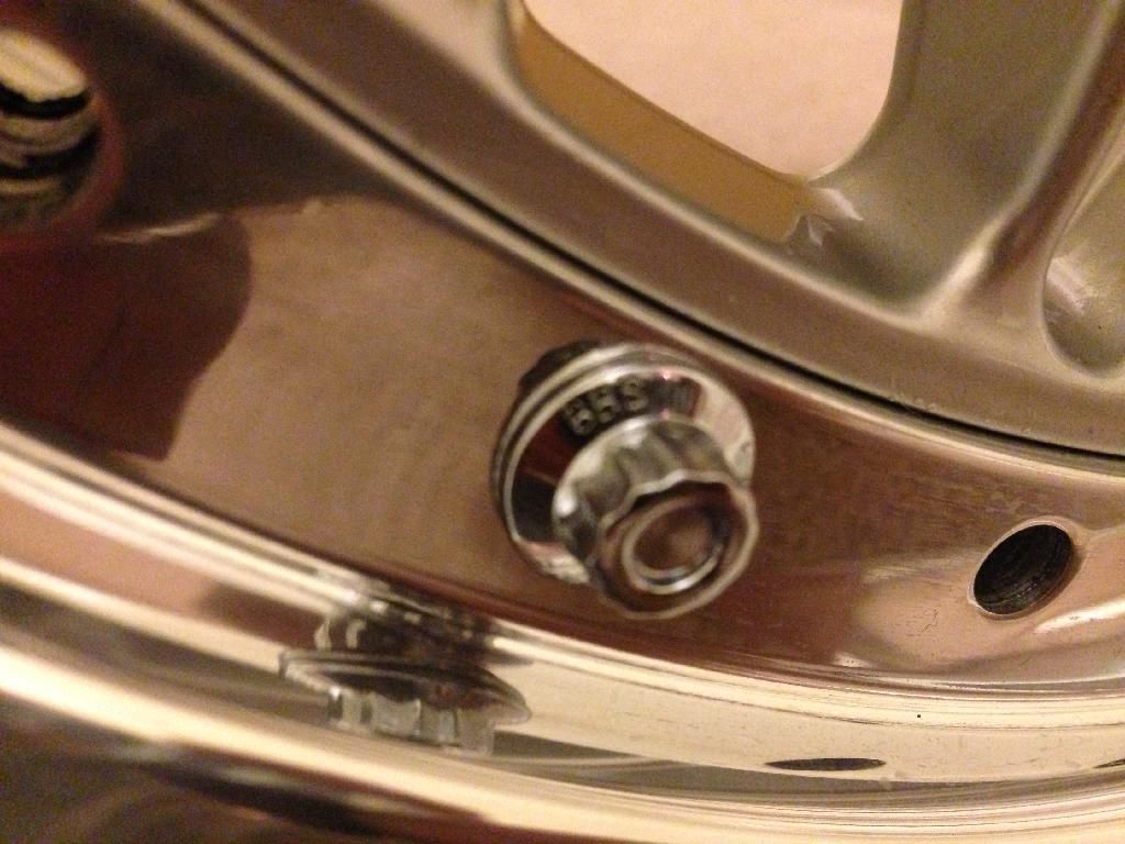

if the paint on the bolts was good to start with then they can be polished in a tumbling polisher using wallnut shells or similar, however if the finish on the bolts is damaged then they will need to be re-finished after polishing or they will rust within days.
For a home polish throw them in a jar of vinegar for a few days then put them ina drill chuck and polish against a brillo pad to start, and then later a buffing pad...but this WILL remove the finish so they will need re coating either with chrome for a shiney finish, or at worst clear coat.
basically its not really a home job unless you ahve all the gear, and if you did you probably woudl not need this sort of advice!!
for info this is how i did mine, i just painted the entire middle section bolts an all, and polished the lip. easy peasy and low maintanace.
and five years later...

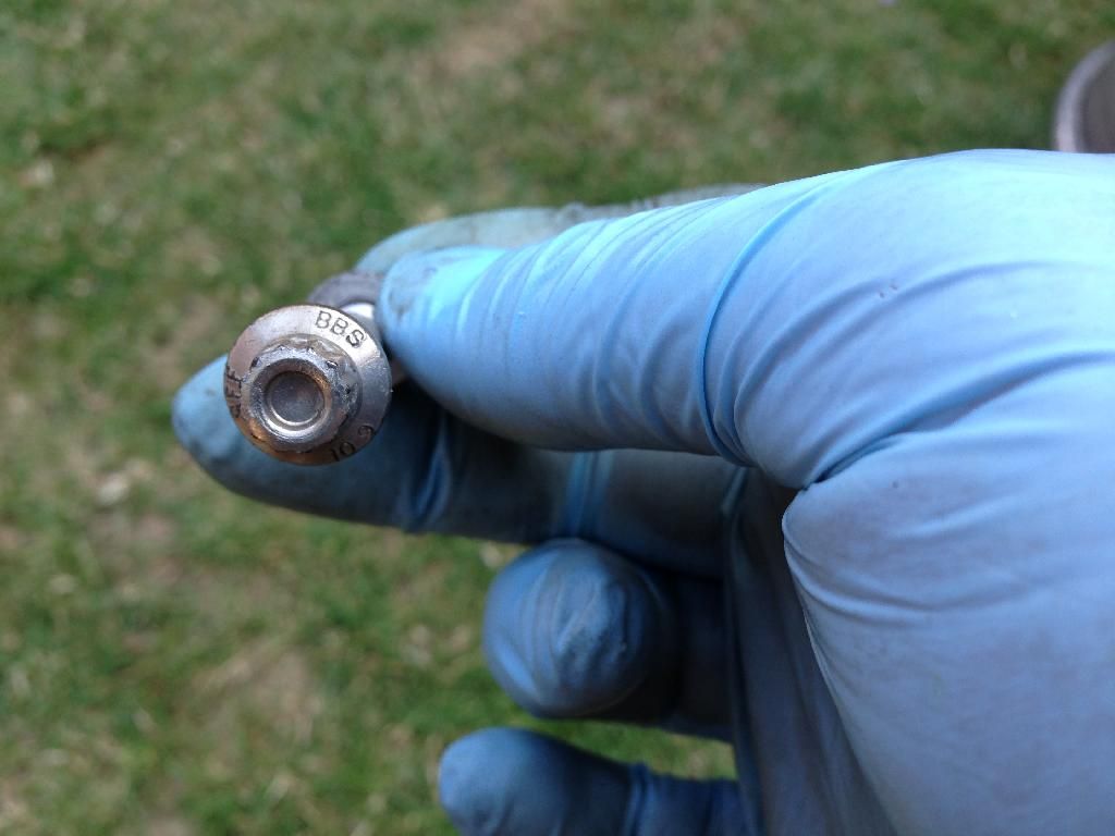

Wed Apr 23, 2014 6:57 pm
I got my orginal BBS rs bolts re chromed and the nuts zinc played by theses guys
http://www.collinschemicalblacking.co.uk/
Think I paid a pound a bolt and 50p a nut.
Wed Apr 23, 2014 7:03 pm
From this,
To this
I also bought new lips because a, I wanted to go wider and b, I didn't fancy spending hours tediously rubbing them down.
