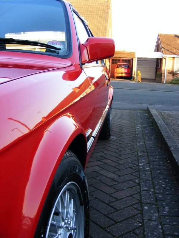

By 'geo'd' I take it you mean actually had the set up checked, by laser or whatever?
The answer is no. I only bought it on Sunday.
This is the best shot of the toe I have atm. Im only going by mk1 eyebal on the matter at the moment.

rears on an e30 should never be toe out, they toe in as standard and as the suspension compresses (or if it's lowered) the offset of the mounting points mean both camber and toe in increase.
any toe out at the rear will certainly make it pretty lairy!
worn inner edges won't help either as as mentioned above, as the car squats under acceleration it'll gain negative camber which will put more load through the (worn) inner edges.
get some decent tyres on the back, and get the tracking checked so you know exactly what you're starting with.

Forgive me if I question you on something gnarkillius but what do you understand by 'toe in' in relation to the rear wheels?
I think you are saying toe in when you mean negative camber, which is created by lowering the car.
'Toe in' would mean the wheels are angled sideways, like when you walked pigeon toed, with the toes in.
The rear wheels will have some negative camber which means that the top of the wheel sits inside the arch a little bit and the wheels splay out at the ground - that's negative camber.
15" wheels and decent tyres will make a big difference. Your current tyres on 14" wheels are what? 195... with 15" wheels you can have 205/55 tyres, so much more contact with the road.

Toby, yes, I mean Neg camber then. Just slight, and yes Im on the stock 14 bbs wheels.
Im on the lookout for some 15 bbs right now, as I dont want to put some nice tyres on wheels I have no intention of keeping.
Saying that, they might still toe a bit, Ill see and ressurrect the thread if anything shows up in the alignment/tracking test when I get it done.
