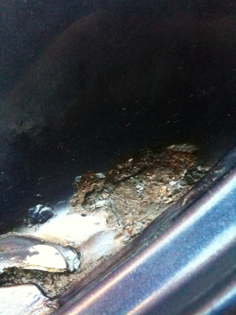

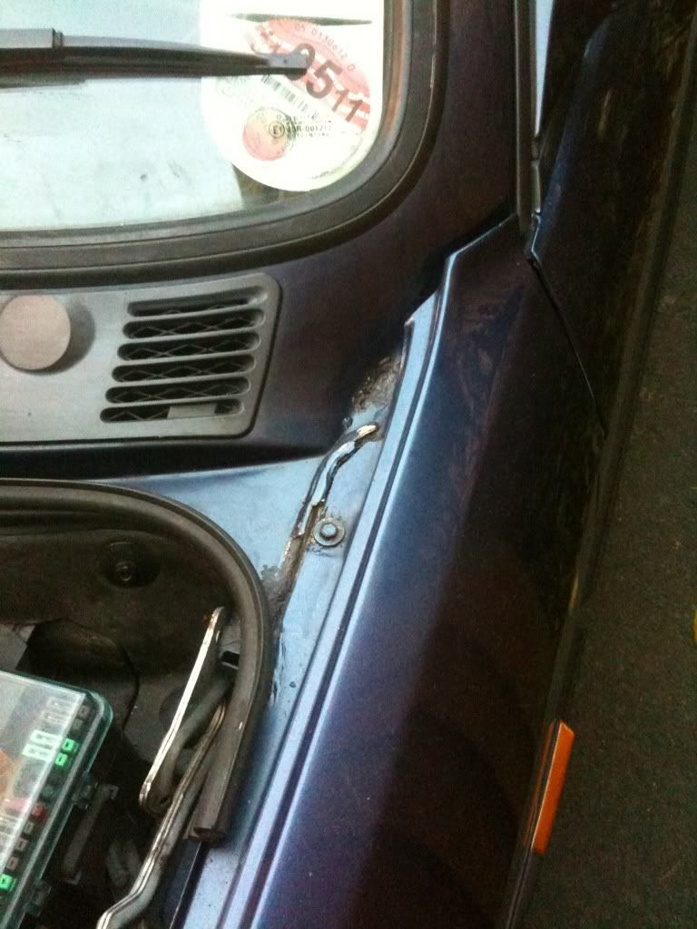

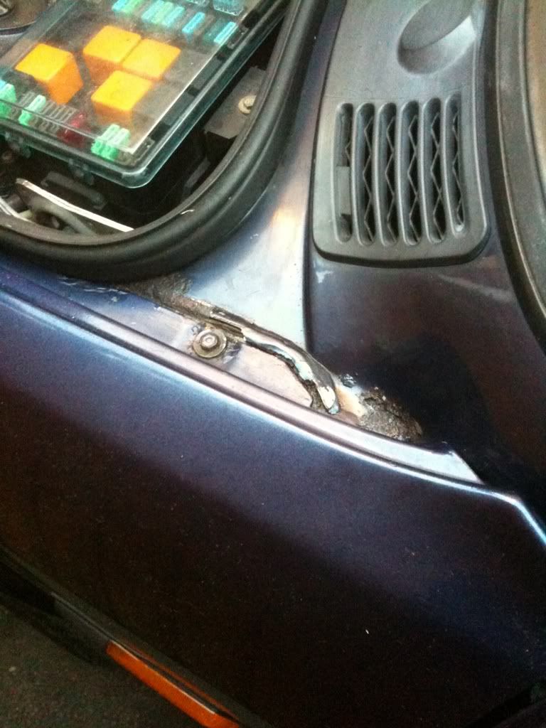

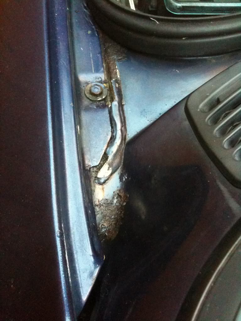

Scuttle rust.
I poked it to see if it will go through, it didn't.
Don't know how to cure it.
Diy posssibe?

screen out, wings off, check the holes at the bottom of where the rubber sits are clear sand back any bubbling and if not too bad remove with sandpaper. treat with krust then fill, sand, fill. sand, clean with prepaint then lightly apply primer, bit more primer. then get a good painter to finish.
where are you based?
or to have nil rust move to florida, oz, california or Bahrain :thumb:

that scuttle bit could be a whole lot worse once you have poked around a bit more. that is holed, you can bet the corrosion on the back is a couple of inches across. looks like its gone through at the corner, once you have the wing off check the hole through to the heater box, looks like that could be corroded too.
could be a tricky one.

If the scuttle is as bad as that there will be more hidden else where. Front jacking points, sills, front and rear inner arches, bulk head and rear battery tray all very common places for they old turds. Sunroof try if you have one needs inspection. I am not saying it will but check all these places before you start repairing this area.

Thing is it has been resprayed at some point. Jacking points are mint arches perfect. Its had new springs/shocks boot has no rust. Sunroof has some surface rust in some spots but have treated this and plan on repairing it in the summer.
Im not going to throw it away at the first bit of rust. :roll: Esp as its my first motor.
gonna have the wing off this weekend to have a look see. fingers crossed eh.
Cheers for your info/help

If you're going to take the wing off, get some Panel Sealer (comes in a tube, like bathroom silicon sealant) so that when you put the wing back on it's sealed properly. Otherwise your inner wing will rust out too (like mine has!)
