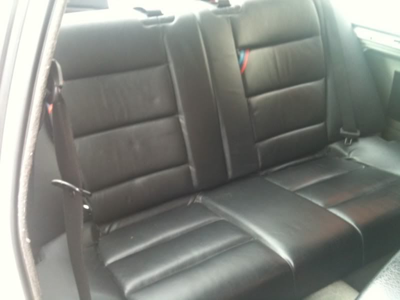

well they are in........ and fitted with no problems with the plates i had made for the front seats. Back seats are fixed together as they are 4 seperate pieces. They do sit slightly proud of the rear parcel shelf but i will alter the shelf to suit and fit the headrests in. The base does not sit further forward than original e30 base so therefore no legroom is lost.

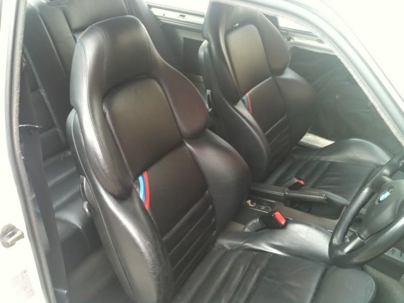

cheers not really, only big task is having the brackets made for the vaders but if you wanted you could just drill the new holes in place but as i didnt want any more holes i had some brackets fabricated. This then allowed me to fix the vaders to brackets then brackets to original e30 mounting points.
The rear seat comes in 5 parts - 2 outer bolsters, 2 centre pieces then the base. The base fitted more or less perfect (just positioning), then i fixed all four rear pieces together to stop the individual movement. Then bolted them to the back. I just need to decide wether to keep the original e36 seatbelts (centre of seat) or the e30 ones. I can ditch the e30 ones then use the e30 stalks on the outer bolt holes for the e36 belts.
Next task is the parcel shelf as the rear seat sits slightly proud if you look through rear window, not a major issue just have to raise the shelf somehow. cheers for the comments. :D

Cheers mate, yeah I wasn't keen on non e30 interiors but I really like the vaders after owning an e36 m3 so I just had to have them again. If I didn't think they suited it I certainly wouldn't have fitted them plus they,re not that bigger when placed next to the original sport seats just a wider subframe. :D
