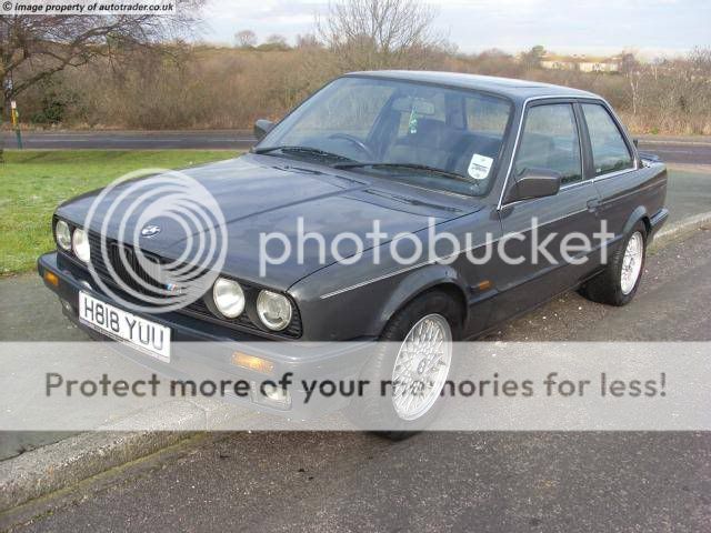

I'm viewing this over a cheap 318i Auto ;)
It's got 15" BBS, 2 door, dolphin grey with fsh apparently, sub 100k too !

Im picking this up tomorrow!
Turned out to be almost perfec!
Only issue was a slight rust patch on the rear valance near the exhaust, both wings slightly dinted and a small dent on the bootlid.
Lovely other than that! My dad drove it as I dont have 3rd party cover but it was great!
