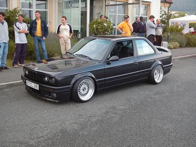

So what I'm aiming for looks wise is this:
Now before anyone says, I know this will require serious arch modifications and will be very difficult to drive in the real world. But what I'm hoping to acheive is a look as close to this as is possible without compromising driveability.

Well.. Seeing as there is a pic of wider above yes

da4x4turbo wrote:So what I'm aiming for looks wise is this:
My car will on some occassions be used as a daily driver.
The rears on this are HA 11x16 ET 09

da4x4turbo wrote:
Alan31625 wrote:i am doing the same thing very soon on my touring.
i am planning 8.5 x16 on the front
and 9.5x15 on the rear.
some arch rolling and mild flaring will be needed on the rear
Hey Dude,
Do I know you? I can't think of any red tourings around Cork?
Do you know if the rear arches definitely need modification to fit 9.5J's ?
Or if the front arches need any modification to fit 8.5J's ?
Cheers :D
the red car is a sport. my touring is grey.
rears def need modding for the 9 an a halfs and the front will need a roll for the 8.5s
da4x4turbo
Posts: 866
Joined: Wed Mar 09, 2005 11:00 pm
Location: Circumnavigating the globe...
Wed Oct 21, 2009 7:29 pm
Oh right, sorry dude I thought the red one was a touring looking at the pic in your signature! :o:
Whereabouts are you in Cork?
Thanks for the info. I'm gonna go for 8.5's on the front and 9.5's on the back, and I'll do whatever I need to do to the arches!
I've been in touch with Tunershop and Justmatz and they can provide the stainless dishes. I need final confirmation of a price from tunershop though.
It'll be epic when it's done!
Anyone who knows of an S50 B32/B30 E30 for sale, please let me know.
