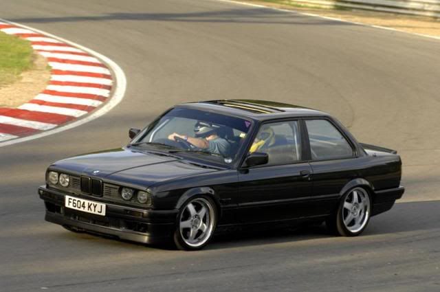

When this photo was taken I was nice and cool inside the car, and I definately wasn't thinking "It's all slow because it's heavy and it might fall over because of all the weight in the roof!"
I love to have the sunroof open, on both hot and cold days, you don't get the wind in your face like having a window open yet there is still a nice cool breeze.
That's more important to me than knocking a tenth of a second of my (probably very amature) lap times! :D
Of the all round enjoyable experience I have driving my car, the sunroof is a good part of it, and it has a roll cage too!
