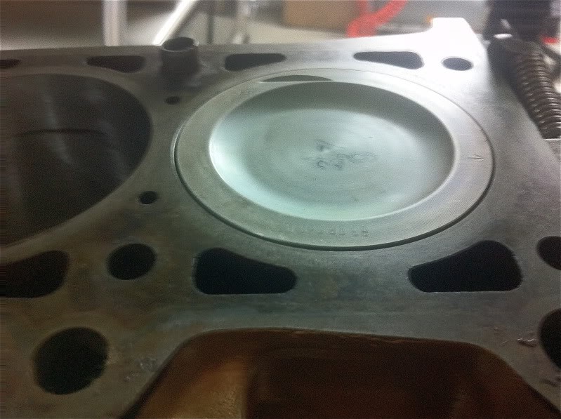

Send the block away to your machinist and have them clean, hone (or rebore) and reface it.
It should come back looking something like this.
Honing.
Refaced.

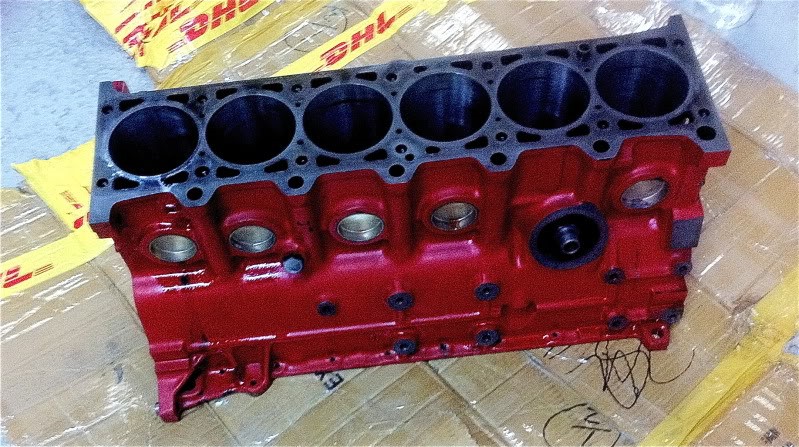

This is typically how it will be straight from the machine shop.
Time for a fresh coat of paint.

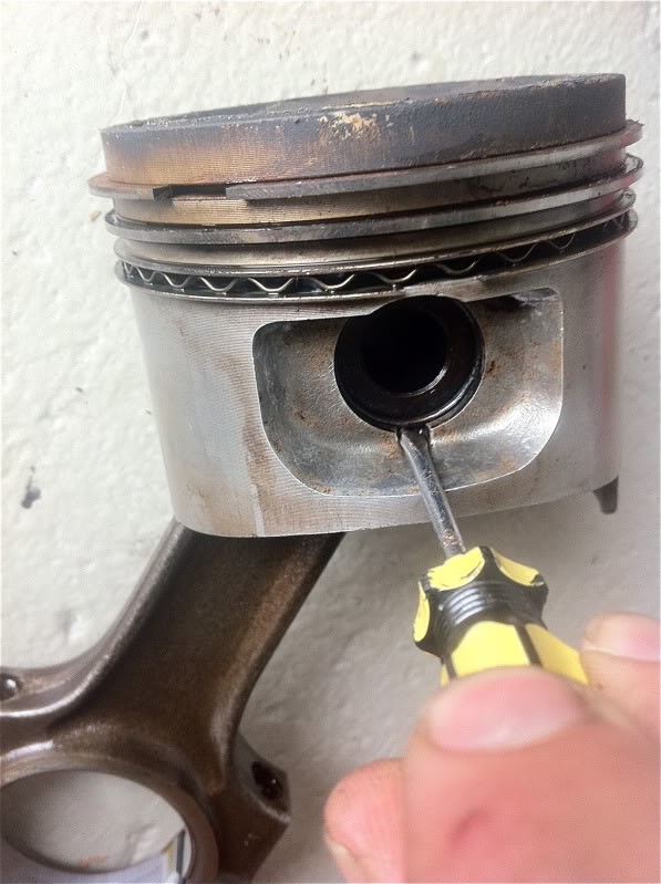

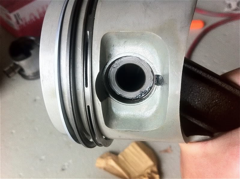

First thing to do is remove the old pistons off the rods... Be sure to do it in order as it is very very important that the rods go back in the block in the same order they were removed.

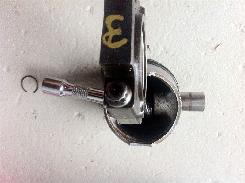

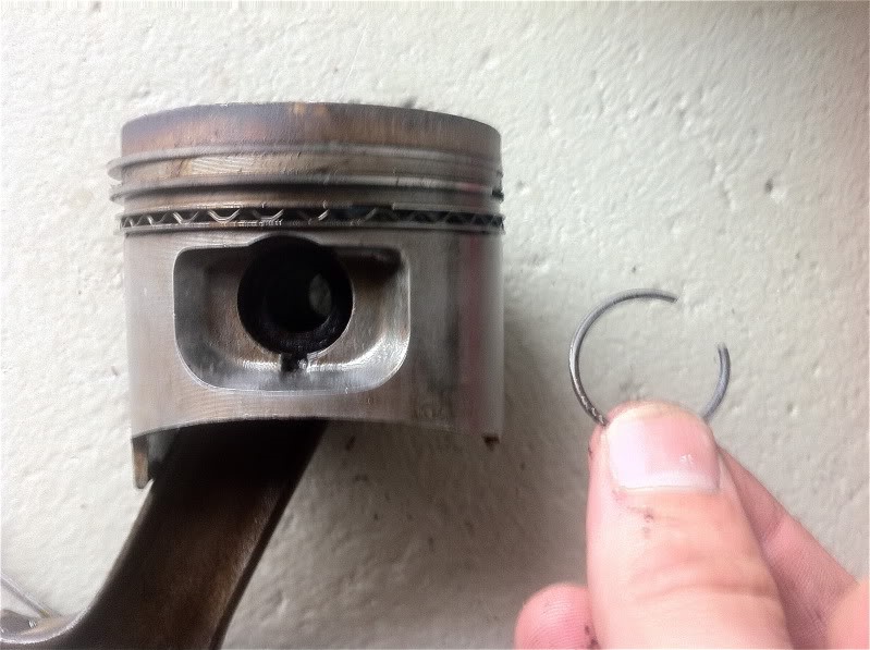

Removing the circlip.
Knock the gudgeon pin through the piston using a suitable drift, be careful not to damage anything... It makes it easier if you soak it in hot water first to let the metals expand a little.

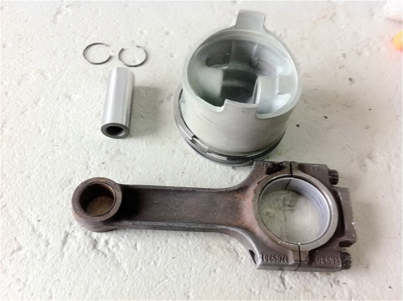

Ready to reassemble with new piston gudgeon pin and circlips.
The circlip goes in this little groove with the greatest of care and frustration- expect a few nicks off your fingers and circlips flying in all directions.
Once you get the first circlip in, you need to grease the piston and gudgeon pin with assembly lube.

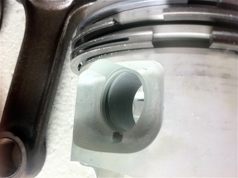

Now it's time to mate the rod to the new piston, start by sliding the gudgeon pin through a little then dropping in the rod and then sliding it all home.. You need to slide it all the way to the end where the first circlip installed earlier acts as a stopper. IMPORTANT- Make sure you have the piston the right way round on the conrod!
Now add the second of the two circlips and you now have a completed piston/ rod combo. 5 more to go.

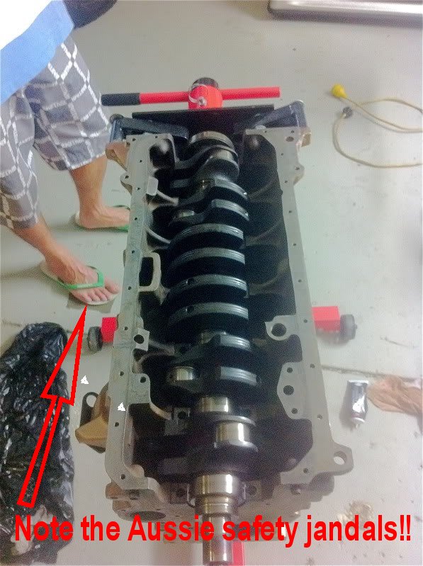

Turn the block over on the stand and it should look like this.
Now we need to add the bearings. They only go in one way but be careful not to bend them.
Some more assembly lube on the bearing faces.

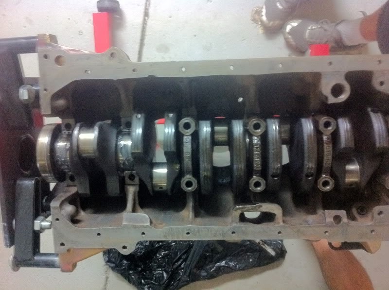

Time to drop in the crank- be very careful, as, even though they are heavy and steel, they are fragile and, if dropped, they will break. It's best to use two people.
Some assembly lube on the crank.
And put the main bearing caps on with the other side of the crank bearing.

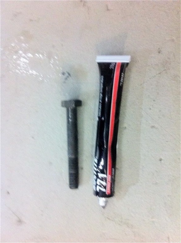

When bolting them down be sure to use some anti seize on the threads. I don't torque them up- only nip them up.

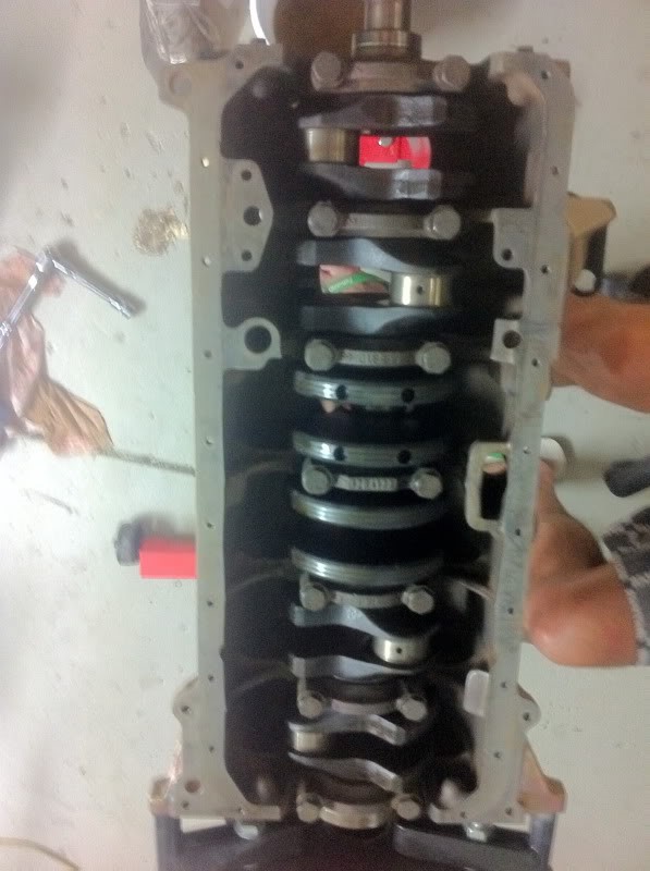

Once there all on and nipped up, rotate the crank so number one cylinder is at TDC so the crank is pointing up in number one cylinder.

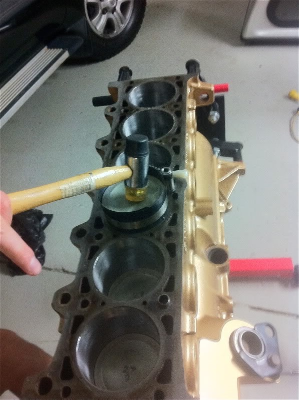

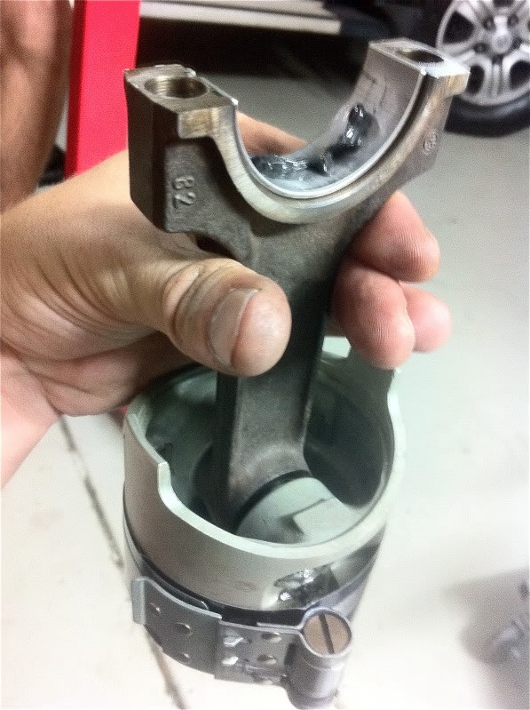

Prepare the piston and rod with some assembly lube on your new rod bearings. Put your ring compressor around the piston. ??I'm told to keep the ring gaps away from the thrust face. Try and line the ring gaps up with the gudgeon pins.??
And knock your first piston home.
Some assembly lube on the rod cap, Be sure to put the cap on the right way around. (this is where your markings come in handy)
Bolt your rod cap down with new rod bolts.. They are stretch type so they need replacing every single time they are removed (one time use) Use some anti seize on the bolt threads and just nip them up for now.
Rotate your crank so its pointing up in cylinder number two. and then repeat the process through all six pistons
Knocking the piston through the bore with the ring compressor using a rubber mallet.
Once we have all six pistons and rods home its time to do it all up tight.

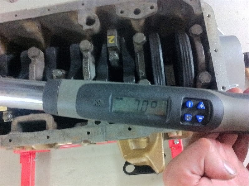

this should be done before assembling the pistons/rods into the block The crank bearing cap bolts get done up to 45ft-lbs starting from the middle and working your way to the ends.
The rod bearing cap bolts all get done up to 15ft-lbs starting in the middle and working your way to the ends.
The the rod bearing cap bolts then get done up a additional 70 degrees starting in the middle working your way to the ends.??

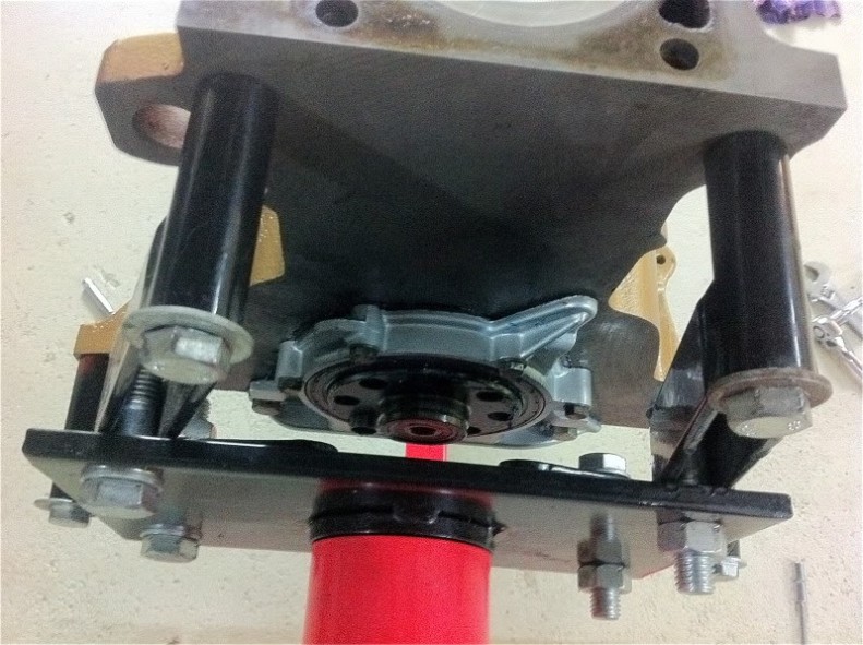

Now add the oil pump and do that up to 16ft-lbs.

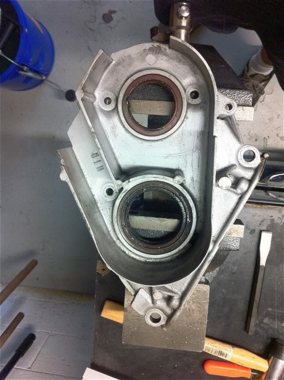

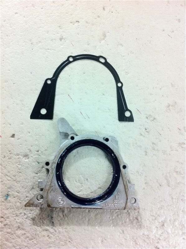

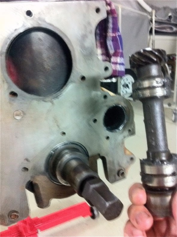

Now that that's all done, it's time to prepare the front and rear engine plates. The rear one carries the rear main seal and the front one doubles as the timing case, it also carries two oil seals one for the crank and the other for the oil pump drive.

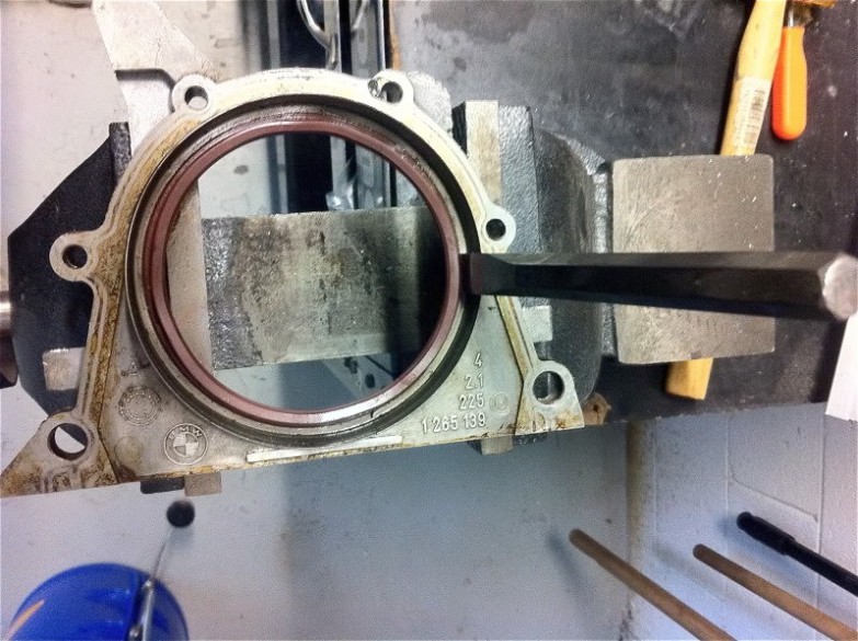

First thing to do is knock out the seal in the rear engine plate: use a blunt chisel and work your way around being very careful not to damage the plate. If you damage it you might end up with a oil leak so take your time... If you have a big socket or pipe you can press it our which is the best method.. ( I didn't have anything that big)
Same goes for the front timing case, For this one I used a socket on the smaller seal and part of the engine pulley to press it out in the vice.
Both plates with their new seals with a fresh coat of paint ready to be re installed.
Next thing to do is slide the oil pump shaft in with some pre assembly lube.

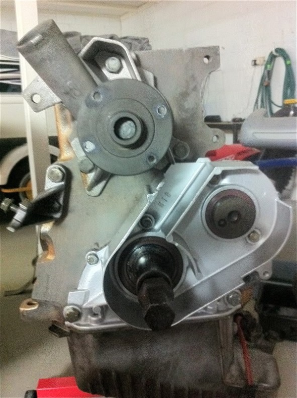

And then install the timing case on the front of the engine with a brand new gasket, be careful not to snare the oil seals as, if they get damaged, you will have leaks.. I pack everything up with grease to make it easier. While your at it put the water pump on with its gasket.

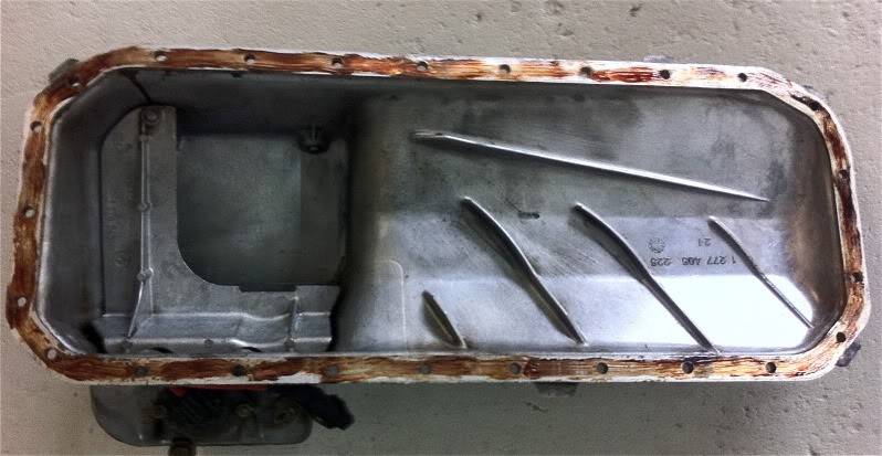

Now its time to prep the sump, I use a gasket sealant as well as the gasket... I find the sealant holds the gasket when lining everything up and makes life a little easier, its also meant to fill in the finest of imperfections between the gasket and sump meaning no chance of leaks. (If using sealant (ESPECIALLY silicone), use it VERY VERY sparingly!!!)
Bolt it all up using the 10mm bolts to 11ft-lbs.

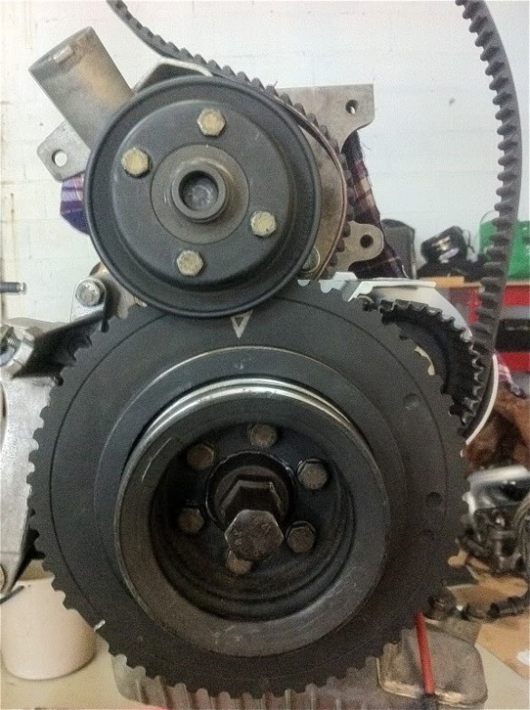

Now add the small crank pulley sliding it over the key way in the crank. Also the oil pump pulley and timing belt.
Now add the toothed timing wheel.
And now its time for the water pump, alternator, power steering and A/C pulleys.

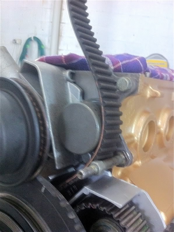

Now bolt your new tensioner in place with its new spring,

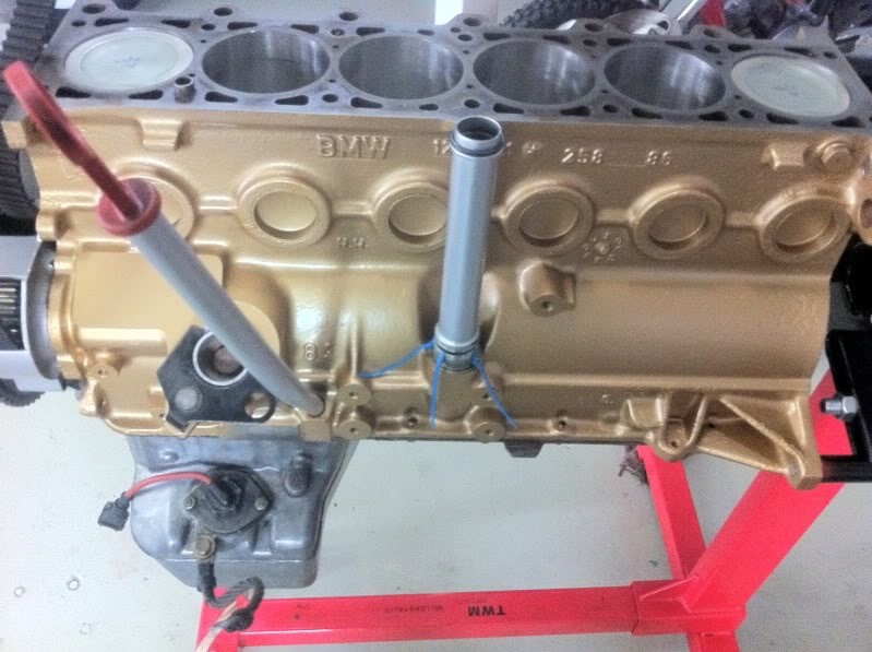

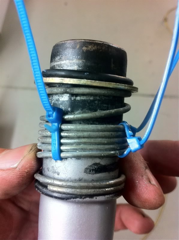

Might want to add the dipstick and breather tube.
When adding the breather tube be sure to give it two new O rings and cable tie the spring down.

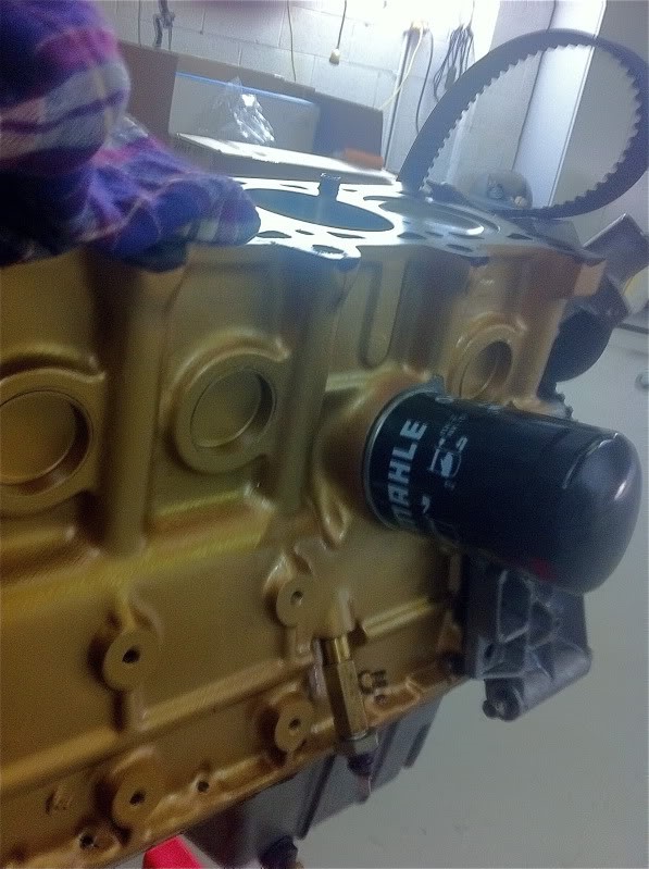

Might as well bolt on the oil filter and oil pressure switch. In this motor I have added a T piece for a oil pressure gauge.
The bottom timing covers turn.
And now its ready to time up the bottom end ready for the head.
The toothed timing wheel has a marker on it, and its indicated with the marking O l T, I have highlighted it with white marker. The white line must line up with a marking on the timing cover.

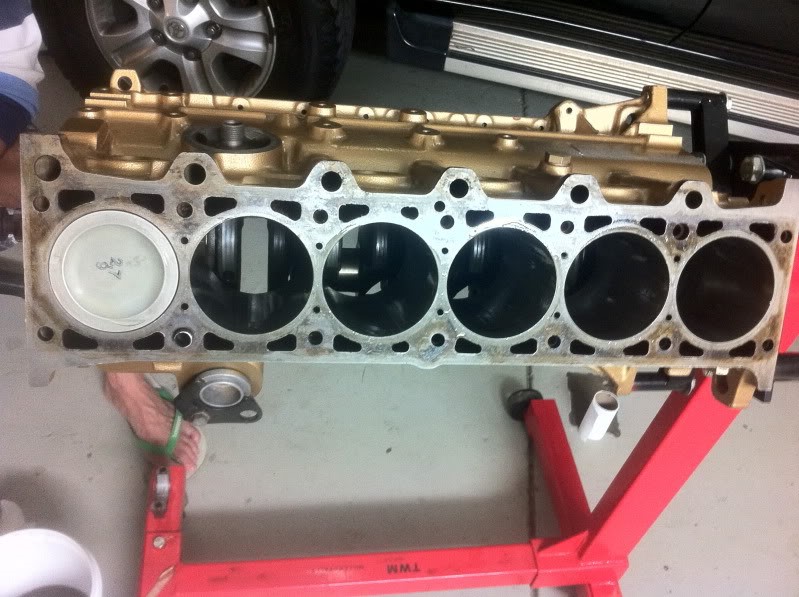

You will know when it's right as piston one and six will be right up the top of their bores.
As this is a high comp engine the pistons protrude just a little out of the bores. This will be taken up by the head gasket.
