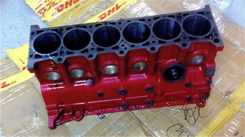

Send the block away to your machinist and have them clean, hone and reface it.
It should come back looking something like this.

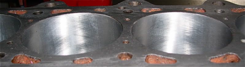

Honing.
http://i39.photobucket.com/albums/e200/m_jermyn/Building%20a%20m20b27/Engine2.jpg

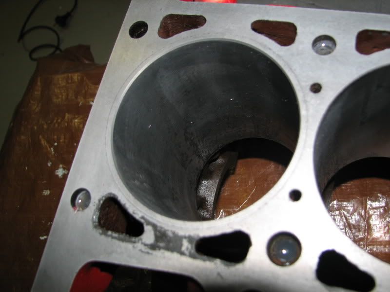

Refaced.
http://i39.photobucket.com/albums/e200/m_jermyn/Building%20a%20m20b27/Engine3.jpg
