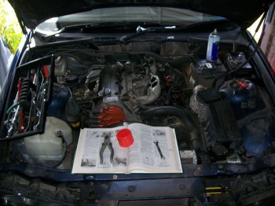

First thing to do is get the bonnet up. Take the heat shield off from above the fan and radiator. Also the plastic scoop that's at the base of the windscreen. They both just unscrew/unbolt. No tricks to removal.
Next remove the top half of the inlet manifold. This first needs you to unhook the throttle cable. 2 Bolts and the plastic part just unhooks from the throttle body.

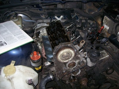

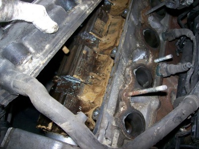

Next step I made was to undo the bolts that hold the rocker cover on. Think there are 8 bolts on the top of the cover. This bit comes off quite easily.
In my case it was very obvious at this point that it was a head gasket failure
You can also lift up the plastic cam cover to show the cam
Don't remove the cam or cam caps! BMW cams are hollow and are extremely difficult to remove safely. You don't need to remove it, so leave it where it is.
In this photo I've also removed the distributor cap and spark plug caps and HT leads. Dizzy cap is just 3 10mm bolts. Make a record of which HT lead is for which cylinder! There's also a plug that plugs in underneath where the inlet manifold was. Unplug that. There's one of the plug caps that plugs into the coil to the left of the engine.

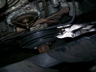

From here the job is made a lot easier if you remove the fan and housing. To remove the fan you need to unscrew it from the water pump which also spins. Requiring the locking tool. In my case I clamped a set of mole grips onto the pulley which as I spun it locked against the belt. Not professional, but it worked and was free. Note that the nut is left hand thread, so you turn to the right to undo it. It's a huge size as well, think it was 37mm. While it's locked you may as well remove the pulley from the water pump. There are 4 bolts. It's easier if you remove the belt first which is slackened by moving the alternator. Which is a 13mm locking nut on the back, then twist a mounting bolt on the front.

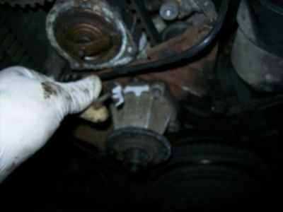

From there you can remove the water pump. 4 bolts hold it in. If it's a tight fit you can screw 2 M6 bolts at the top and bottom. There are threaded holes in the pump and the bolts should push against the block, pushing the pump out. What is most likely to happen is that the lugs on the water pump will just snap off, leaving you to remove the pump with gentle strokes of the hammer.

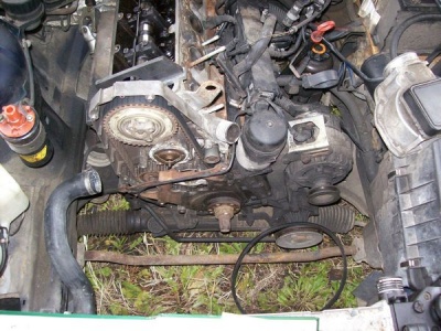

In order to remove the lower belt cover the crank pulley needs to be unbolted. There are five 13mm bolts, but you can't really see them. There's also a 22mm bolt on the end of the crank, you may need to hold that still in order to remove the pulley bolts. Undo the 13mm bolts and then both pulleys can be pulled off. Note there's a locating pin so it goes back in the right place. The belt can be slackened and removed by adjusting the power steering pump (on my model anyway, it changes if you have aircon).
Now you should have something resembling this:
A few more bolts on the lower belt cover and that can be removed too. Pay attention to the routing of the cable and where the cable clips are situated. Personally I label the bolts/nuts as I remove them so I know where they go.

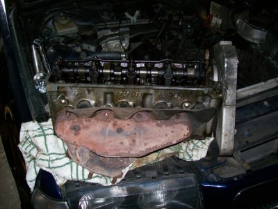

Undo the head bolts and get under the car. There are 3 bolts that attach the exhaust manifold to the down section. Undo those, it can be fiddly. From there the head can be lifted off, it shouldn't need any wiggling or hammering. Mine just lifted clear off.
Head off

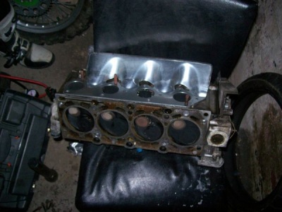

Bare block, just lift off the old gasket, and put the new one on.
My gasket kit came with a new exhaust heat shield. It also came with valve stem seals but I didn't use them.
At this point you should check the head for any visible warping. If the head is warped it needs to be skimmed by an engineering firm, it's not particularly expensive but if it needs it and you don't do it, it'll just ruin the new head gasket instantly. Any warping most likely won't be visible so may need to also be checked by an engineering firm.
