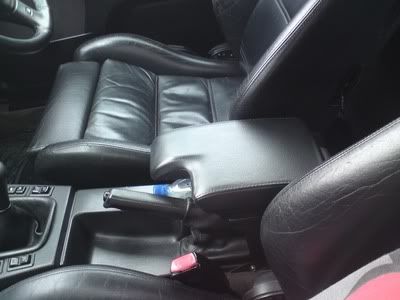

Adding an e46 armrest is a pretty easy job, it adds that touch of class and comfort to the interior of an e30, and is a great addition which incorporates style as well as function, as it reduces fatigue on long journeys, looks perfect in the interior unlike the oem e30 armrest which looks very tacky and the usual ebay stuff from china, which is too high to be useful and looks like something that should be bolted down in a vauxhall astra that crashed through halfords!
[IMG]http://i223.photobucket.com/albums/dd261/maf8899/DSC04299.jpg[/IMG]
It doesnt invade your arm space when changing gear as well, its just below the gear knob so its at the perfect height im around 5'8 and its perfect for those long journeys where you can just kick back with the car in 5th, heated seats on and just relax!
Unfortunately the armrest had allready been in my car for some time when this page was made, so I’m backtracking and showing pics when its already installed its just to give you an idea but all in all very simple to do!
The brackets can be made from a piece of steel or metal its basically an upside down "L" , no idea where the ones in the pics came from, but anything similar should do. A bracket with a point at the bottom is good as I find the bracket does take some strain when leaning forward it looks like it is doing something! So this is also ideal, the brackets are partially covered by the seats and the seatbelts as well.
