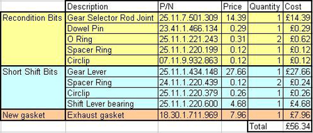

PLEASE NOTE: The Gear Lever is now part number - 25117527252
The only parts that you actually need for the conversion are the ones highlighted in blue. The remainder of the parts are required if you plan to change the selector rod bush which will not be covered in this write-up as it's a good 8 hours work and much more involved than simply swapping the shifter. Here is a picture of the parts required... you can see the difference in the E30 and Z3 levers. The Z3 lever is the one on the right. The shorter throw is gained by the much greater distance between the ball joint and the selector rod joint.
