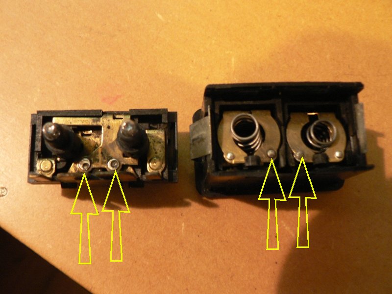

Now you will see the following. Arrowed are the points that burn up. Use an earbud and a small screwdriver to clean all the burning off and get both contacts shiny. Use contact cleaner if you have some (you can buy it from electronic shops).
Once you have them all clean like shown below, put the base back into the main frame and press together to close. Hopefully your switch will work for a while to come!!
