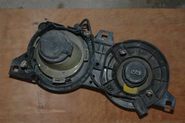

This is a basic idea of how to get yourself smoked Hella/Bosch lights for a very little amount of money (around a fiver), and around a weekend of messing about. My lights are Bosch units with a projector type main beam from a ‘92 cab, I think that some, if not all, older BMW’s (i.e. pre facelift) have slightly different driving lights that are not the projector type. I cannot tell you if this will work on them. My ’87 325 Sport is an American version that has fully sealed beams, alas American sealed beam type cannot be converted. The picture below shows the rear of my lights.
