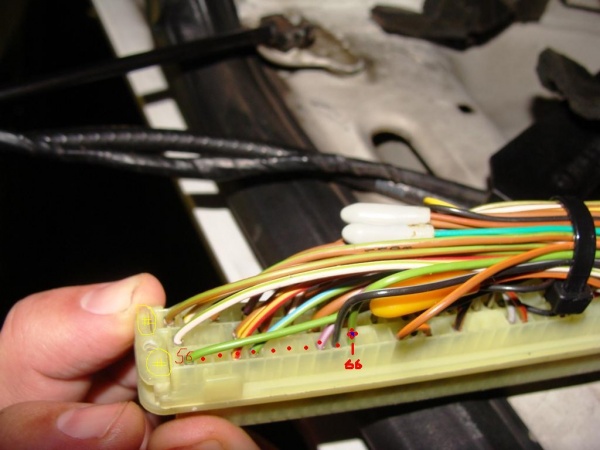

If you really don't want the hassle of the EWS system, it is possible to deactivate it by swapping in a non-EWS chip into your ECU. However, depending on the loom you have, you may need to make some minor adjustments to the wiring. This technique is required for for OBD-I looms, which usually come with the 413 silver label ECU (as fitted to the E36).
Swapping the ECU is very simple, but on these older looms you need to cut one wire that leads to the ECU. Therefore, you will need to unclip the plug from the ECU and undo the small screw that holds the plug cover over the wires. With this removed, you will have the wiring exposed like this:
When looking at the wires, identify the very small numbers on the harness (circled in yellow) and find wire 56 at one end of the plug. Count over to the 66th wire, which should be a green wire but is sometimes black and purple. Cut this wire cleanly with wire cutters, then reassemble the plug and connect your replacement non-EWS ECU.
