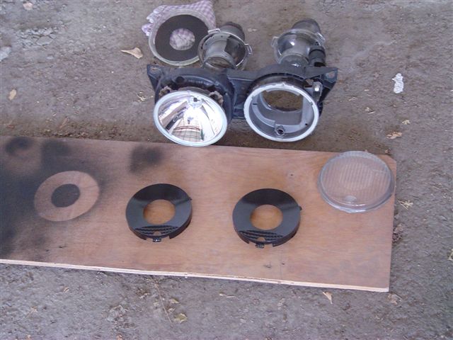

If you get to this stage the rest is real easy. The driving light has a slivered piece of plastic (yours may have a smiley cut out but mine doesn’t) this is held in with the same glue, use the gun carefully to warm it up and pull it off. Them simply spray ‘em black! I personally painted the whole reflector, but as I was also fitting angel eyes at the time I was removing the side lights. You may want to keep the side lights and in this case you may want to tape off the side light reflector area. Best bet if you are unsure is to tape it off first, spray it and test it, you can always spray it black later if unsatisfied. Personally I would spray it all black and sod the side lights but check for MOT requirements. Heat proof paint will stop it cracking and I used a glossy finish, but think a matt finish may have looked better, can’t help you, so up to you, again comments welcome. The picture below shows my reflectors painted black! Remember follow spray can instructions, clean and dry the reflector, hold can 12-13inches away, sweeping motions, and lots of thin coats leave to dry between coats. Practice on a coke bottle or bit of wood first if you cannot spray paint, get it right and it will look good. Get it wrong and you will be disappointed.

Smoking the main (high) beam
This bit is a little more tricky and even involves cutting and sticking! The idea is to make the interior of the light appear black but still allowing the mirror to direct 100% of the light foreword toward the road and rabbits. The driving light uses a projector system thus the reflector you have painted black has little effect, but the high beam uses a bulb, concentrated and directed by a mirrored reflector, thus it’s reflector cannot be sprayed black. Those of you who have already done so (as you are confused which is high beam and driving lights) can also go down to the scrappies as you have f*@%ed your main beam and now need a new one! The trick is to fool happy passers by (and non-E30zoners) into seeing a black reflector, this clever trick accomplished by inserting what I call a thingy. The thingy is a black piece of plastic or metal shaped in a 3D cross that sits in your main beam reflector, perpendicular to the angle of the mirror, and splitting the reflector into four quarters (What???). The thingy (well the mirror really) reflects its black colour around the reflector bowl and hey presto it appears black from certain angles! Its extremely hard to explain this shape so look at the pictures to the right.
I could not buy one of these thingies so I made one myself. Sorry no pattern as I stuck it together before I had chance (mine also modified to accept angel eyes). I experimented with cardboard and scissors until I found the shape of the reflector bowl, I then used a piece of 2mm galvanised steel sheet and cut the shapes out with the tin snips and finished with a high speed cutting drill (a Dremel). It will take a bit of messing around but what to do! Once you are happy with the shape of your thingy glue it together with epoxy glue and leave to set. Then spray it black. Again take your time spraying and the results will pay off. I sprayed my thingies, let them dry, then popped ‘em in the oven for an hour at 70-80° and baked them to fully harden the paint.
