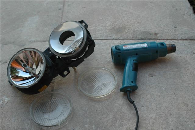

You will need a basic tool set, mainly consisting of screwdrivers. You will need a hot air gun of around 5kW, I used a Makita you can see the type in the pictures. You will need a hot glue gun. You will need some tin snips or if you can find one, a Dremel (or any very high speed drill with a cutting disk). You will need some 1 or 2 mm Aluminium, steel or tin sheet. You will need some Epoxy glue and some high temp silicone (I used gasket silicone happy to 600°). And finally a tin or two of heatproof black spray paint.

The idea next is to heat up the glue that bonds the glass lens to the plastic driving light and the metal high beam light. Use the hot air gun to heat the lens for around 10 mins. I have heard some people put their lights in the oven facing the grill to heat them up, that’s your choice but to do that you may have to disassemble the lights further. Any comments I would be glad to hear them, but I like my way. Once you have heated the glass and glue for 10 mins or so get two small flat screwdrivers and slowly and carefully use them to prise the lens off. The main beam has glass tabs you can get behind with the screw driver, the idea is to work at it for a bit, then apply heat for a few more minutes, and work at it again. Don’t rush, it is unlikely you will get the lens off first heat cycle, rushing it will result in a broken lens and a trip to the scrappies, yes I did it. The driving light has a plastic backing and I prised mine off from the bottom of the light, where it will be less visible, I managed to melt and break a small amount of the light surround first time but it will be hidden by the metal ring when you re-assemble them anyway so not to worry. Trick seems to be keep the heat gun moving aimed at the lens/glue area so you don’t melt the plastic holder. Again I stress work at it for a while then heat again repeating until it comes off. Here is the silly part, my first attempt had me finally prise the lens off and as it fell from the holder is went to catch it with my hand, and as it was at around 1000000° of course I dropped it and broke it, hence the gloves, and eye glasses.
