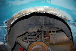

=Rear Inner Arch=
=Rear Inner Arch=
[[Image:DSC_040.jpg|thumb|right|A rusty rear inner arch]]
[[Image:13022010015.jpg|thumb|right|A rusty rear inner arch]]
The welded seam in the rear arch is a known water trap, especially considering all the spray thrown up by the wheels. Despite BMW's best efforts, the smallest hole in this seam will rapidly spread out to rot the inner wing where it enters the boot. Unfortunately for the owner, the water normally collects in the side "boxes" where your jack is stowed, and you'll only see it when you go to change your tyre. The rust will show up as orange water stains on the paintwork if you're lucky; if not you'll be seeing the asphalt from inside your boot.
It is possible to cut out and repair this rust, but it is never fun laying on your back trying to weld upwards. However, simple patch panels can be folded to repair simple holes, while entire inner arch sections are available if needed.

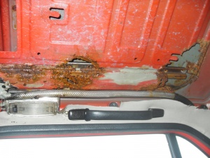

=Roof=
=Roof=
[[Image:DSC_040.jpg|thumb|right|A rusty roof]]
[[Image:rust006.jpg|thumb|right|A rusty roof]]
A rusty roof is the only spot on an E30 that is considered terminal. While any metal work can be chopped out and replaced, the immense effort required for roofwork makes any repair uneconomical at best, and a complete b*stard at worst.
Roof rust shows itself as tiny blisters on the roof surface, bubbling up from underneath. If you have these blisters, you will need to take off the headlining inside the car to confirm the extent of the rust, but be prepared for a shock. A lot of the rust in these cases comes from the [[Sunroof|sunroof]], specifically the cassette mechanism that holds the sunroof in place.

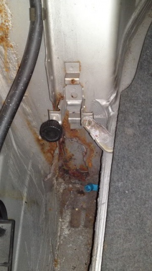

=Floor=
=Floor=
[[Image:DSC_044.jpg|thumb|right| rusty inner wing]]
[[Image:IMG_0624.jpg|thumb|right| rusty inner wing]]
The floors on E30s is usually fairly solid, but there are one or two spots where rust is guaranteed. These spots sit at the front corners of the floor, and look like little square cups. These are incorrectly called "jacking points", and any attempt to use them as such will cause serious damage to the floor of the car. Certain mechanics don't know this, so it's highly likely that your car will have been lifted from these cups at some point in their life.
As soon as this is done, any underseal around them will have been broken, allowing road salt in to munch away the metal. You won't know it until you start noticing your carpets are constantly wet, by which time it will be too late.
The best repair is to cut out all the bad metal and let in flat metal plates. There is absolutely no need to replicate the "jacking points", as you are guaranteeing more rust in the future.

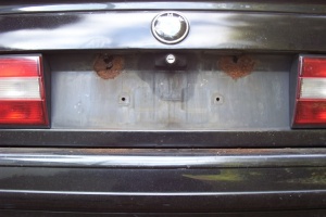

[[Image:numberplate.jpg|thumb|right|A rusty bootlid]]
For the most part, the bootlid fitted to 2-door and 4-door [[Saloon]]s is pretty sturdy, but the vertical part that fits between the rear lamps is covered by a plastic shroud. This shroud is a moisture trap, and water gathers behind and starts rusting the panel from behind. It's almost impossible to notice unless you see crumbling orange powder on the floor of the boot, at which point the plastic shroud should come off for an examination.

Rear Inner Arch

Roof
A rusty roof
Roof rust shows itself as tiny blisters on the roof surface, bubbling up from underneath. If you have these blisters, you will need to take off the headlining inside the car to confirm the extent of the rust, but be prepared for a shock. A lot of the rust in these cases comes from the sunroof, specifically the cassette mechanism that holds the sunroof in place.

Floor
rusty inner wing

Boot
A rusty bootlid
For the most part, the bootlid fitted to 2-door and 4-door Saloons is pretty sturdy, but the vertical part that fits between the rear lamps is covered by a plastic shroud. This shroud is a moisture trap, and water gathers behind and starts rusting the panel from behind. It's almost impossible to notice unless you see crumbling orange powder on the floor of the boot, at which point the plastic shroud should come off for an examination.
