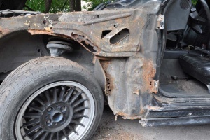

[[Image:DSC_0404.jpg|thumb|upright=1.5|right|[[User:Grrrmachine|Grrrmachine's]] rusty inner wing]]
[[Image:DSC_0404.jpg|thumb|right|[[User:Grrrmachine|Grrrmachine's]] rusty inner wing]]
The Inner wing, especially the flitch that supports it, can rust from behind the plastic wheel arch guard, and go un-noticed for years. The only signs will be scabbing along the top edge of the wing where it's bolted, inside the bonnet. If you see rusting along that edge, get the wing off and inspect immediately.
The repair can be made in situ, as long as it hasn't spread to the [[Rust#Bulkhead|bulkhead]].

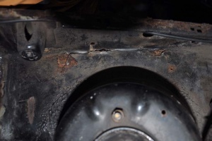

[[Image:DSC_0461.jpg|thumb|right|[[User:Grrrmachine|Grrrmachine's]] rusty suspension turret]]
The inner wing sits on top of a much more sturdy metal plate which forms the base of the suspension turret. Over time, water seeps in between these two skins and rots out the turret from the inside out.
It is possible to cut out and repair the thin sheet metal, since this usually doesn't affect the structure of the turret itself, but if the crack spreads too far it weakens the strength of the inner wing.

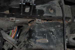

[[Image:DSC_0409.jpg|thumb|right|[[User:Grrrmachine|Grrrmachine's]] rusty fuse box]]
Bulkhead rust is most evident as water leaking down behind the glovebox (or pedal area on LHD cars), leading to orange staining. It should also be seen as a spreading crack underneath the [[Fuse_Box|fuse box]] (seen with fuse box removed).
This can be one of the most problematic repairs, since the [[Loom|wiring loom]] travels through this area, and cannot be removed without stripping the interior entirely. However, lots of small patches will allow you to slowly rebuild the holes left behind, but will require more exploratory cutting to find the true extent of the problem.

Front Inner Wing
Grrrmachine's rusty inner wing
The repair can be made in situ, as long as it hasn't spread to the bulkhead.
Front Suspension Turret
Grrrmachine's rusty suspension turret

Bulkhead
Grrrmachine's rusty fuse box
Bulkhead rust is most evident as water leaking down behind the glovebox (or pedal area on LHD cars), leading to orange staining. It should also be seen as a spreading crack underneath the fuse box (seen with fuse box removed).
This can be one of the most problematic repairs, since the wiring loom travels through this area, and cannot be removed without stripping the interior entirely. However, lots of small patches will allow you to slowly rebuild the holes left behind, but will require more exploratory cutting to find the true extent of the problem.
