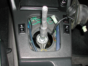

Make a start by jacking the car up and securely supporting it on axle stands at the front. First up, get in the vehicle and remove your gear shift knob. If you have an original BMW knob, it should pull straight off with a bit of force. If you have an aftermarket knob, then check with the manufacturer for removal instructions. Now remove the gear shift gaiter, this should unclip at the base and lift off. Beneath the gaiter you will see a large round rubber grommet unclip the reverse light switch and remove the grommet, it will just pull free. You should now be able to see the floor beneath your car through the hole and it should look something like the picture below.

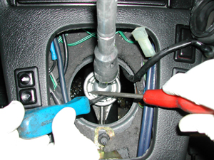

Once the selector rod has been removed, get back inside the car to remove the old shifter. Use two screw drivers against each other to force the locking ring round to release it. You will see in the metal housing that it sits into, a couple of locating recesses, rotate the locking ring until the fat tabs of the locking ring line up with the recesses and then pull the shift lever straight up. It should come free but be careful not to hit yourself in the face with it. You can see from the picture below the double screw driver method used to unlock the locking ring.

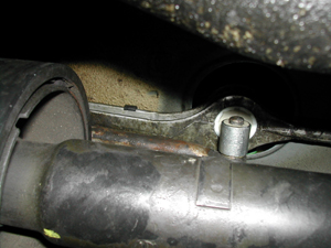

Next the selector rod needs some careful modification. We need to place a slight bend in the selector rod so that it clears the vibration damper on the prop shaft. This is caused by the extra length of the new Z3 shift lever below the ball joint. The best way to do this is to place it in a vice. As we didn't have a vice to hand, we made good use of a hammer. Place the selector rod between two supports and give it a few sharp hits with a hammer. It should look something like this.
Refit the selector rod beneath the car and replace the yellow spacer rings and circlips. Get someone to change the gears inside the car while you check underneath for clearance of the vibration damper. If the selector rod touches the vibration damper then remove it and bend slightly further.

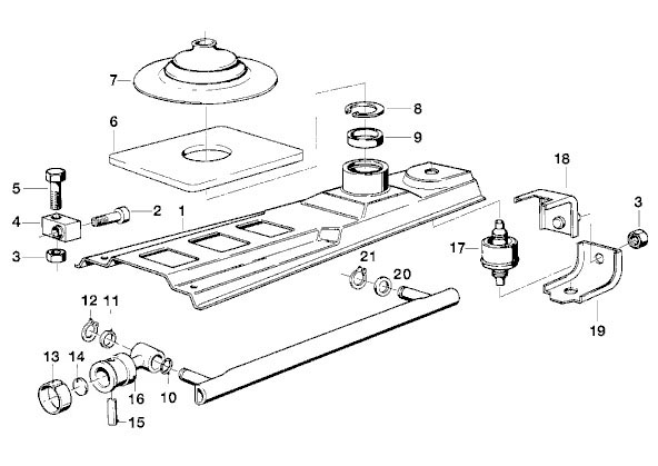

For pre-facelift cars, you may find your carrier is different to the design used in the above guide.
In terms of console bushings, there are three. In the diagram above, they are parts 4 and 17. It's also worth getting a couple of 2's, as they come with locking material on them (and are known to back out of the transmission). It can't hurt to get a couple 20's and 21's either, as they are easy to lose and the clips are easy to break. For a proper job, 14 is a rubber washer that wears out over time.

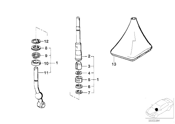

For the shift lever, you really don't need any parts. You can reuse ones off of your old shifter, but you have to grind down the metal ball and it's a real chore. Considering how cheap the parts are, it's better just to get new ones.
Number | Part Number | Quantity |
8 | 23 41 1 200 844 | 1 |
10 | 23 41 1 466 110 | 1 |
12 | 23 41 1 466 112 | 1 |
For installation, you're going to have to file down the inner rim of the upper ball cup to slide it down over the Z4 lever.
