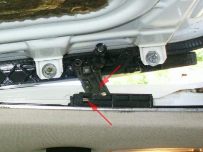

If you're adjusting the panel, the Bentley manual talks about placing 4mm hex wrenches through holes in the guide rail (bottom arrow) to slide through and engage the tilt track (top arrow) on both sides, thereby keeping the sunroof sliding mechanism held solidly together during the adjustment process. Strangely enough, I couldn't see any way the hole would match up with the track when the sunroof was closed. I closed the sunroof and stuck the hex wrenches in there, but doubt it engaged anything useful. Maybe my sunroof mechanism is a bit different?

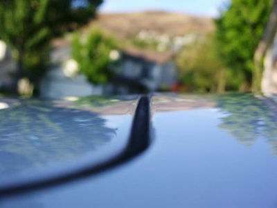

With the sunroof in the standard closed position, have a second person hold the rear edge 1mm above the roofline while you tighten the back screw and repeat for the other side. During this process, I held the mechanism down with my fingertips from the inside, trying to mimic the purpose of the 4mm hex wrench described in Step 4. Hold the front edge 1mm below the roofline and tighten the front and middle screws. All six screws should be tightened to 3 to 4 ft-lb.
