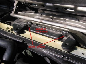

You'll probably want to take off the bonnet. It makes the job infinitely easier. Before you do, mark around the brackets onto the hood with a marker. The brackets are made with oversize holes so that the bonnet can be fine tuned to line up perfectly with the body panels, and if you don't mark the bonnet, you'll have fun adjusting it when it's time to put it back on. Once you've marked it, remove the 4 outside bolts and loosed the 2 inner bolts. At this point the bonnet can be lifted off its brackets and set aside.

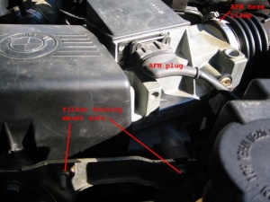

I removed the air filter housing before starting. This is definitely not necessary, but it emptied up a lot of space in the engine compartment, and it was easy to do. Remove the two mount nuts for the filter housing, disconnect the connector from the AFM, and loosen the hose clamp clamping the AFM to the rubber ductwork leading to the throttle body. Then unclip all of the clips on the filter housing as if you were replacing the filter (be careful the don't fall!), and remove the rubber duct from the intake of the filter housing by pulling it out. Lift out the top part of the filter housing along with the AFM, and then remove the lower part with the filter.

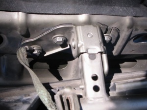

First, remove the splash guard from under the car. This is a black shield of sorts that keeps water from splashing up into the engine compartment. Mine has three square holes in it. Remove this by taking off four 7mm or 8mm screws holding the splash guard to the brake intakes, and then the four 10mm plastic nuts holding it to the frame (two on each side). The splash guard will now come right out.
The next thing to do in the engine compartment is remove the radiator. I'm told that it is not absolutely necessary in order to replace the timing belt, but I can't imagine doing the job with it in. First you have to remove the fan and fan clutch. For this you'll need a 32mm combination wrench. Chances are that you, like me, don't (or didn't) have a 32mm combination wrench, so you'll need to get one. I tried using a really big adjustable wrench, but it was too wide and wouldn't fit on the nut (the mounting screws for the water pump pulley were in the way). The fan clutch nut is reverse threaded, so, looking at the engine, you will have to turn it clockwise to loosen it; this is significantly easier from under the car. Since you won't be able to hold the fan in place, the only way to loosen the nut is with sharp impacts to the wrench with a hammer. Once you've loosened the bolt, spin the fan to remove it and set it aside. Keep it upright, however. Storing the fan clutch on its side will let the fluid drain from the fan clutch.

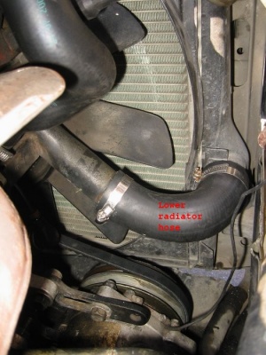

Next, you'll need to drain the coolant, which can be easily accomplished by removing the lower radiator hose and putting a pan under the opening. There's also a drain plug, but since you're taking out the radiator anyway, it's easier to just remove the hose. Once the coolant is drained, disconnect the upper and lower radiator hoses. Then take out the two screws in the black plastic bracket holding down the radiator from the top. Remove the bracket and lift out the radiator. Drain the rest of the coolant from it by seesawing it back and forth over a pan.

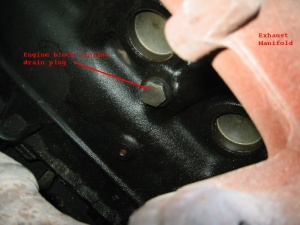

If you're going to go ahead and replace the coolant (good idea), then remove the 19mm engine block coolant drain plug from the right hand side of the block under the exhaust manifold. Use a big pan to catch the coolant, it goes all over the place.

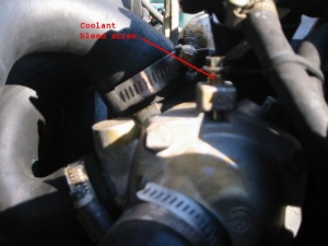

Loosen the coolant bleed screw (8mm) on the top of the thermostat housing. Mine was hopelessly stuck, so I had to spray WD-40 on it, and break it free with visegrips. Hopefully this won't be a problem, but if it is, get a new screw. If you go ahead with the old one, you'll have to bleed the system again when you replace the screw.
Before you start filling, set the heater control to hot, and turn the blowers on.
Now, pour the coolant in the expansion tank slowly. If you pour it too fast, you'll make it worse come time to bleed the cooling system. Fill the cooling system until coolant starts to come out the bleeder valve. Start the engine, and once it warms up, a mixture of coolant and air bubbles should start flowing from the valve. Allow the engine to run, while keeping the expansion tank filled, until air bubbles stop coming out with the coolant, and only coolant flows from the bleeder valve. Pay attention to your in-car heater too - it should be blowing hot when there's no more air in the system. Once you're sure, retighten the bleeder screw before shutting off the engine. If you shut off the engine before tightening the screw, you'll have to bleed again. Be careful while running the engine with an unbled cooling system. Keep a close eye on the temperature gauge, and if it gets even close to the red, close the valve, shut off the engine, and start again when the engine cools down. When you start again, crank the engine before opening the valve.
