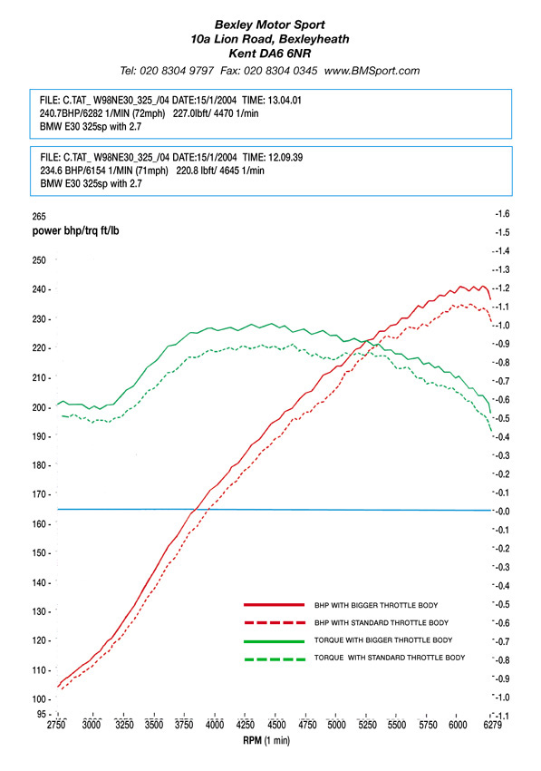

The test comprised a simple before and after power run. The first test with the standard 325 item showed the car to be producing a very respectable 234.6 bhp at 6154 rpm and 220.8 lb/ft of torque at 4645 rpm. This is a lot of power from such a package which is largely down to a combination of Jags mechanics and Nigel’s expert mapping over the years.

Nigel was beaming when the figures popped out of the computer. This simple mod had hiked the bhp up to 240.7 at 6282 and the torque up to 227lb at 4470 rpm. The curve characteristics had changed for the better too.

Results
